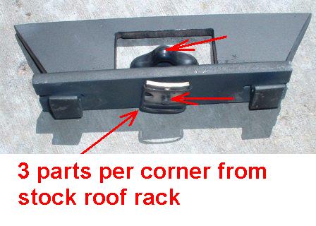

anybody confirm what the rails will support?
i wanna attach a basket to the stock rails and load it w/ >200#
and i need the L-thumb wheel harware from the stock crossbars

thats on the crossbars and i wont be using them. im refering to the rails the crossbars mount to.
so if each bar could hold 165#, im thinking that the rails would support ~330#
i have an AL basket that was on the FG shell of the P/U. i could stand on it = >200lbs
i want to mount it (& easily removable) to my stock rails.
hardware will be the next thing to figure out.
