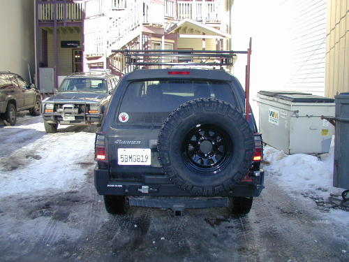

RockWare Snaps Up
Anybody feel like hosting a few pics so I don't have to post them small and one at a time?

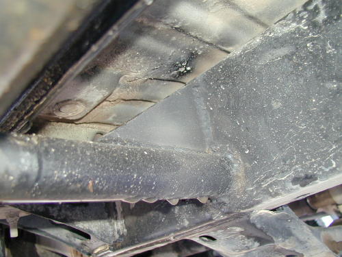

hey wait richard, here are the shots of the gussets they did for me on your sliderz
Old Jan 23, 2004 | 01:21 PM
DSP's Avatar
DSP
Joined: Apr 2003
Posts: 223
From: Telluride, CO
shoot i mean here

That's a sweet rear!

im jealous...i wish my rear bumper was that good looking.....i want to sell mine and get one of those

That is a really nice rear ummm bumper.
How much was it dare I ask?

Why did you keep the factory hitch instead of incorporating it into the new bumper?
Just wondering,
Mike

He will need the stock hitch for towing anything. When I had my bumper put on I asked Matt about the max tow rating for the integrated receiver point. He built it as a recovery point; made to accept pulling forces front to rear, like pulling your buddy out or getting recovered. The issue is with the tongue weight of the trailer. He just couldn't tell me what weight the receiver would hold. He told me his receivers are not meant to tow trailers (at least mine wasn't) and he could not put a pound amount to what it would hold.

Custom made bumpers + towing = liability
I am sure they recommend using the factory hitch for that reason.

So true, but I don't see the point of a custom bumper if the tow hitch is still hanging down below it. You'll still hit the hitch first, therefore no ground clearance or departure angle is gained.
