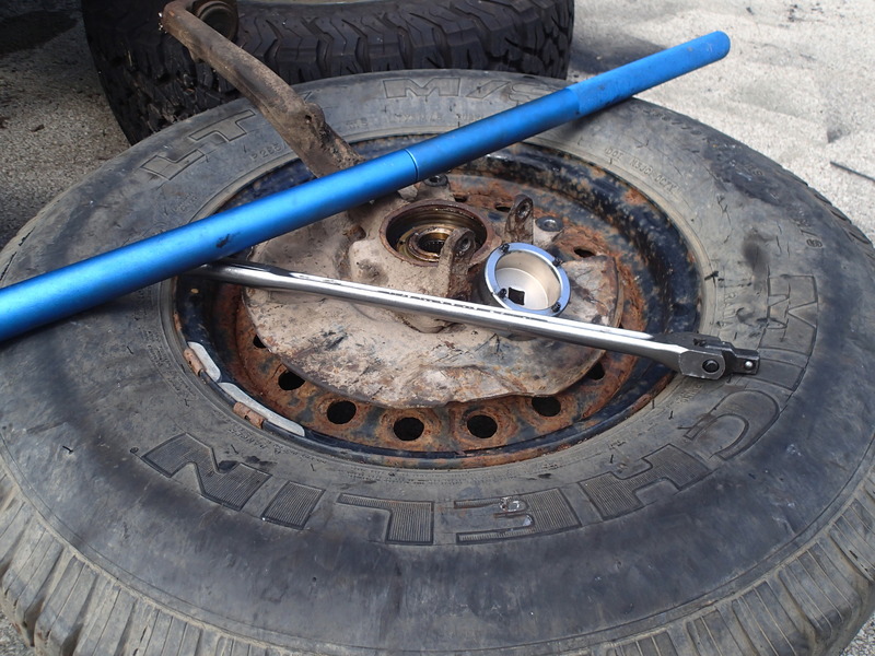

With the 4 holes evenly spaced....yeah, that was fun to break loose ( 203 ft lbs of fun). I used a spare tire to hold the thing in place and stacked people on it, then a breaker w/cheater and steady pressure.

Anywho, the nut you're trying to take off has 4 holes for the tool that Wyoming9 gave you the part number for. I bought my tool off Amazon for $13. Same idea, not as nice as OTC I am sure.

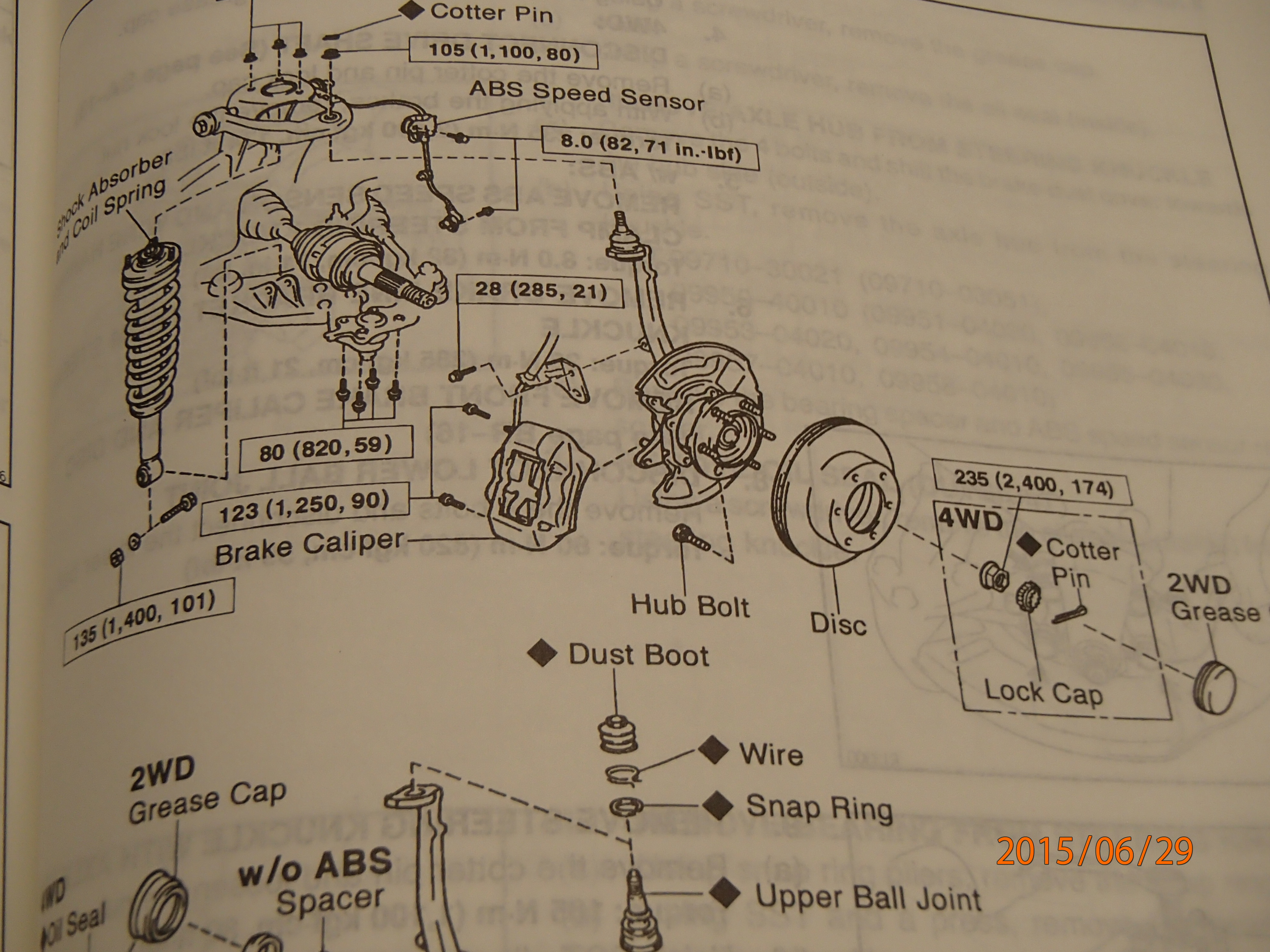

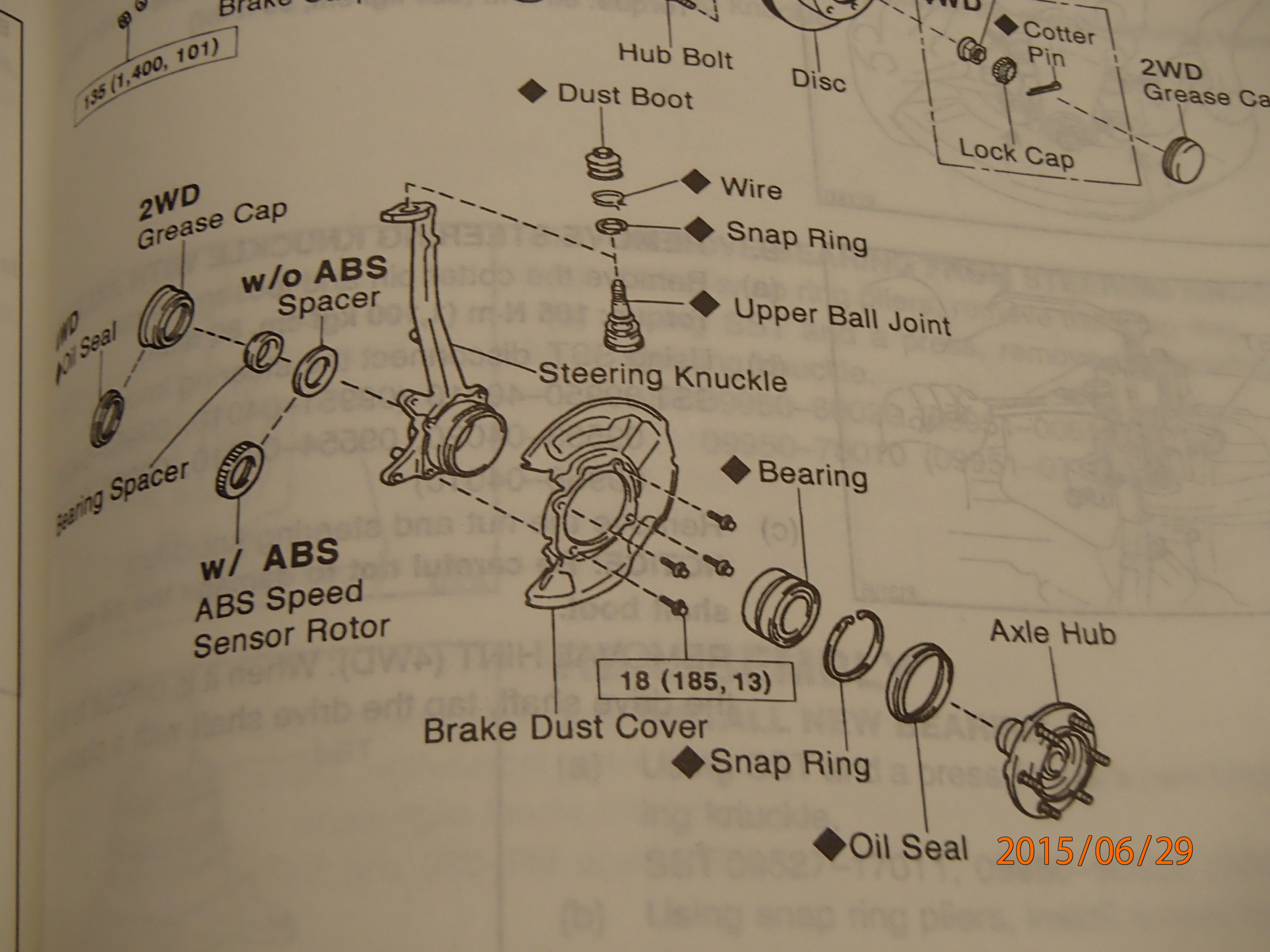

I think where you are running into trouble is the Hub needs to be removed with the steering knuckle.
Meaning the 4 bolts at the lower ball joint and the upper ball joint
The nut your unscrewing Goes in the back of the steering knuckle.
The Hub must be pressed out.
This is quite a bit of work to be just changing Dust covers !!
Now if you were also changing the Ball joints and you had every thing all apart .
Still quite a lot of work.
Then pulling the axles to change backing plates is a lot of work as well

I hope this helps from the 1997 4Runner FSM
Attached Thumbnails replacing brake backing plates and having problems with getting my wheel flange off-001.jpg   replacing brake backing plates and having problems with getting my wheel flange off-002.jpg

As you see in the pic above. I put the hub on the spare tire with the lug nuts to hold it in place, then my kid and husband stood on the tire while I used a breaker bar with extra cheater bar to apply pressure. Hardest part (besides breaking 203 ft lbs loose) was keeping the tool level so it didn't pop out of the holes and damage the pins. The hubby put his foot over the top of the tool and that helped.
On the second one I also used the spare tire to hold it, but then zapped it with the impact when I couldn't break it loose by hand. That was a little easier.
When I have to put them back on I will prolly try cargo straps to hold the spare in place.
