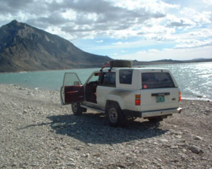

reldnew - what did you end up doing to fix your spare tire situation? i had to cut my spare off to drive across country. i mounted it on thule bars with ratchet straps, which made me look like a safari wanna be, and worked fine, but isn't really ideal now that i'm in the LA area. is it possible to replace the winch with one from a salvage yard? i can't afford the rear bumper and hate to lose the space in the cargo area. the dog would hate me!

ok, bigger image attached. i just need to know if i can salvage another winch for underneath to re-mount the tire or if i'm stuck with the racks or throwing it in the back. the rear swing is on my xmas list, but no $ for that right now. i thought about mounting it upright in the back, was hoping to find ideas on how to do that...
