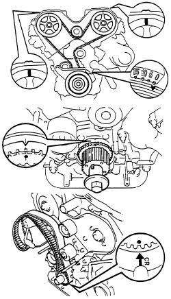

Miss fires on a single cylinder bank...
Suspect incorrect timing belt installation as well.

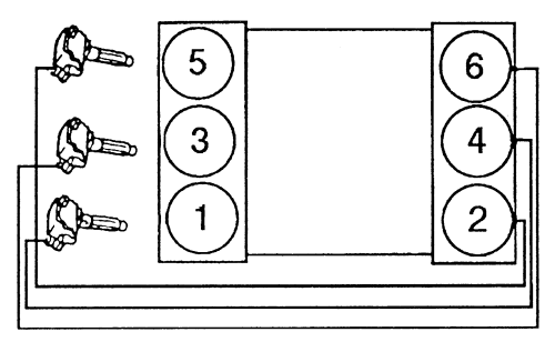

Ignition cables(spark plug wires) installed correctly...?

Yea I'm afraid I'm going to have to tear it all back down an check. Plug wires are def Installed right. I used the same diagram
