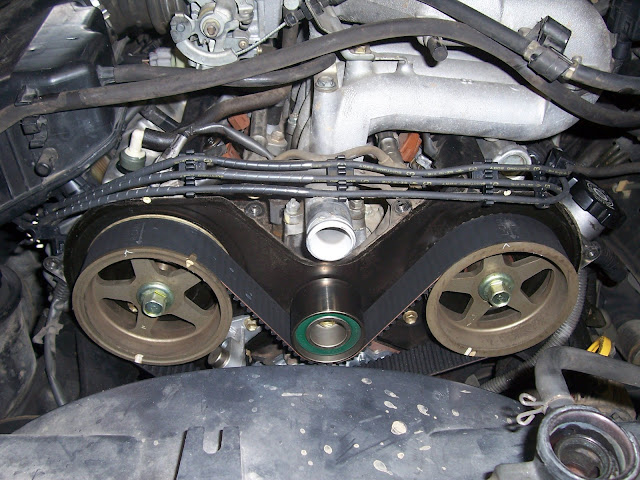

So, I pulled the cover off and rotated it until the cam timing marks and TDC were all lined up. This looks OK, but the marks on the belt never met up with the cam marks.
Is this a problem, or am I really only concerned that the timing marks all hit at the same time? I rotated several times and the belt marks never did line up with the cam marks.
Cam marks ligned up when crankshaft pulley is at TDC.
Belt marks do not lign up with cam marks.

You've found your problem. The belt is marked for a reason.

those marks are there to make sure you have the right number of teeth between all sections...... Take it off and reset it--and you dont have to worry about bending valves--the 3.4 is non-interference.
Who did the timing belt job?
Since I'm at 180K, I decided to skip the dealer and try a new shop this time to try and save a few bucks. So, if the belt marks don't line up, but the cam and crankshaft marks line up - what is it doing to the engine.
Did you get #1 cyl at TDC?
The crankshaft pulley mark is sitting at the 0 deg scale when the cam marks line up. It's my understanding that this indicates that #1 is at TDC. Is there something else I need to check?

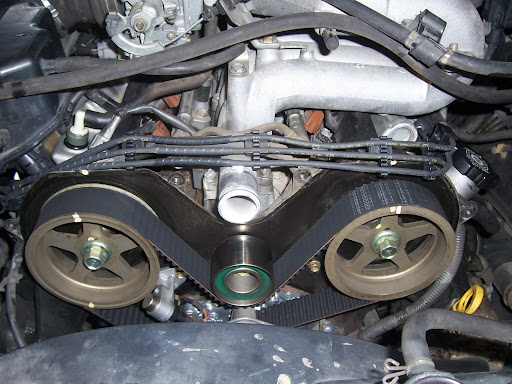

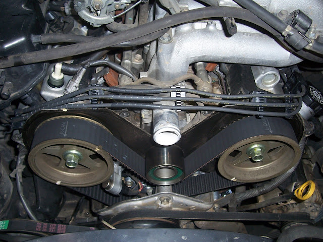

Just to be sure, I went out and marked the cam pulleys where they lined up with the belt marks. I then rotated the engine until the belt made one full revolution and found that the belt had shifted by by 1 or 2 teeth. (See Pic below) So, I'm guessing it would eventually work itself around until they lined up again (After a few hundred revolutions).
But --- does this mean that the rotation of the cam and crankshaft are being rotated slightly out of sync? Would this explain why I only have problems starting some of the times? I'm getting a little out of my league here, but want to make sure I fully understand the issue before I go back to the shop.
Thanks Again to everyone who is helping out.

If the marks are where they are supposed to be on all pulleys/gears...then its in time. The marks on the belt are to assist lining it up on install.
It dont matter where the marks are on the belt....its the position of the cam pulleys/crank pulley at tdc on number one that matter.
Set to tdc on 1. are the cams where they are supposed to be? forget the marks on the belt. If the crank is set tdc 1 and the cams are where they should be...then its something else.

Why not just reset the belt using the marks?
After 720* of rotation--everything should line back up--but it has to be dead nuts on. Each gear tooth is quite a bit of timing.
Make sure you are abolutely at TDC and the cams are where they are supposed to be--
Then make new marks on the belt as per the manual. Then rotate 720* and see if everything lines back up--BOOM--BOBS YOUR UNCLE!!
