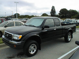

I'd like to turn my black and chrome 1999 Toyota Truck Tacoma PreRunner Extra Cab 2WD (L4-2694cc 2.7L DOHC 3RZ-FE MFI) into a project truck, but there's so many variables I'm not sure if all of these mods are 100% compatible with one another. I thought I'd post it here as this is the most informed Toyota forum I've found. Here's what I'd like to do...
- Get a rebuilt (fresh as possible) V6-3378cc 3.4L DOHC (5VZ-FE) MFI engine (about 190 hp)
- Possibly have it disassembled, balanced and blueprinted (+10 hp)
- Add a few TRD components... intake, exhaust, plate, other suggestions? (+25 hp)
- Add a TRD supercharger (+50 hp), a 7th injector (+25 hp), headers, dual stainless exhaust (+10 hp)
- TRD ECM chip to handle the differences due to the injector and supercharger.
- Mate it with a manual tranny. I don't know if this is possible since the PreRunner only came with an automatic. Might be some cabin and center console mods to accomodate the stickshift and new clutch pedal.
Questions...
All these mods are definitely within the realm of possible, right? I mean, there's nothing ultra exotic here is there? I'd be over 300 hp (maybe more) with mostly factory stuff.
Are there any suggestions for trannies? I drive 90% street so off-road isn't a requirement. Don't need or want 4wd. I'd also prefer bolt-on with as few custom chops as possible. Can I even drop a manual into a PreRunner? They only came with an automatic. Which manual trannies fit?
Would I need a different driveshaft? Different wiring harness? HD clutch (probably)? Is different gearing available (or required) for the rear diff?
Are there any good references or information out there for any of the more tricky mods like the supercharger, 7th inj, chip thing, even Tacoma engine swaps in general?
Considering it's out of warranty now, would you recommend dealership installation for any of this or are all these mods something an average to above average car mechanic could figure out? Which mods would you avoid doing yourself?
Thanks!
