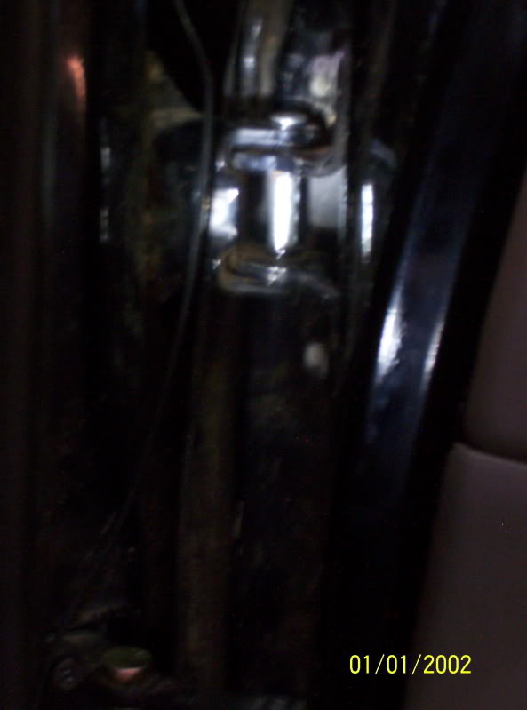

Then Cut the stock pins using the dremel, or other tool. I started with the bottom, then did the top. (only do one at a time to make it easier to put the pins in, and to allow for stability)
Then jiggle the door up and down while forcing the factory pins out.
Once they are out you can let the door down slowely and softly.

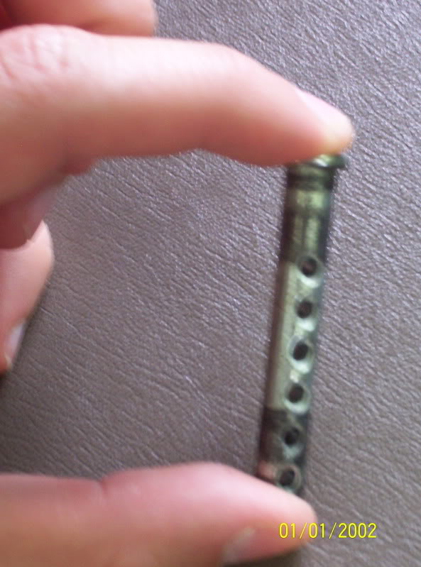

Then get the 7/16ths pin (Im 95% sure i used 7/16ths, if you have any doubts, cut the bottom factory pin on one door, then pull only the bottom half off and take it to the store, if the top half of the bottom pin is left in it will be stable enough for a quick trip. I used standard instead of metric to allow it to be a little bit smaller so it will be easier to fit the pin into the hole.
I used a table grinder to make the tip of the pin into a semi rounded point, so once again it will make it easier to allign, if you can get it a little bit, then you should be able to force it the rest of the way in.

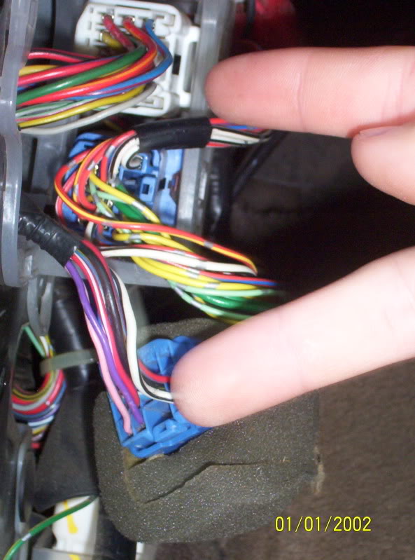

Next unplug the 2 wires leading into the door. The Blue and Black ones on the passangers side, and the Blue and white ones on the drivers side

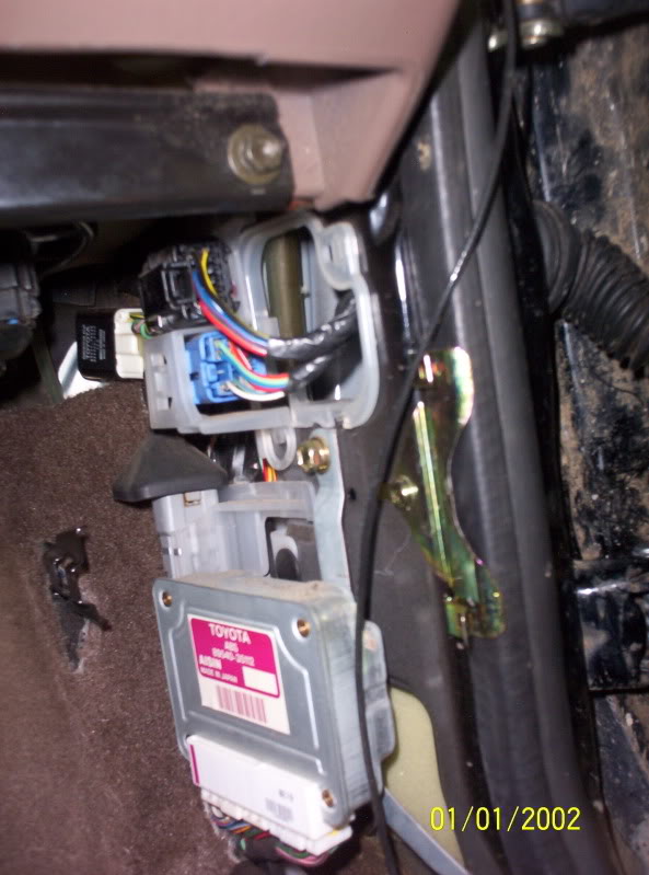

On the drivers side (coming from the door) i unplugged it before the foam connector thing, to make it easier to fit through the door jamb pannel

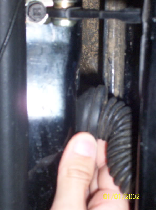

Next pull the rubber connector out of the car door pannel and feed the wires through

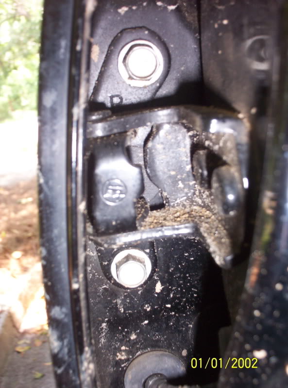

Then so you wont have the dome light on and have to deal with the nagging door ajar signals I unplugged the door sensor. Pull the cover off the center beam post.
And unplug the little wire

The pins are ~~5/16"ths, not 7/16ths. A 2" long celvis pin is just long enough to go through all the way. I imagine a 2.5-3" long pin would be better.
