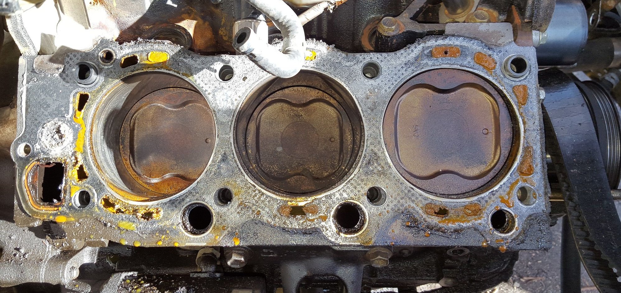

How much pitting is too much for a head gasket to cope with? I bought this truck with a known bad HG, but the pitting on the block was a surprise. It's right at the spot where the head gasket blew, but that couldn't have happened quickly.
I'm not in a spot where I can easily pull the block so I'm debating filling it in with JB Weld. It's at least flat, there's no where on the block a .003" feeler gauge will slip through.

Man, tough to say what I'd do. I might be tempted to try the tiniest amount of JB. Now just how in the heck did that pit like that unless you were running saltwater through it! In old cadillac v8s the FSM recommended using that walnut shell sealer stuff in the coolant, so you might put a tube of that in the coolant after the H/G job.

Just picked up the heads and the guy at the machine shop suggested something similar. "Add some stop leak and don't worry about it." I might add some copper gasket sealant also for peace of mind, but I'm leaning against the JB Weld. At least the sealant wouldn't make it worse.
The truck is 20 years old, 140k miles, and had the original timing belt. I'm going to guess the coolant was never changed either.

That's the way they all look when you pull the heads off. I have a bottle of that copper gasket seal. Stuff works wonders, even on head gaskets. I definitely recommend it.

I don't know the 5VZ but that is about what I find on the 22r motors. The head gasket should fill that void fine I would think. The factory "1" in the picture looks deeper then the pitting by the picture to me. I know it is way off from the leak you had.
Just curious but when you removed the head on your motor, how was the head bolts? Reason I ask is on the 22 motor, I have seen several blown head gaskets that I feel was the result of the head bolts backing out and not necessarily the gasket failing.
Also going from my experience it seems the head bolts that loosen is on the exhaust side more often and really don't think I have seen a head bolt on the intake side loose. Just offering some suggestions and my experience is on a completely different motor.
Now anytime I have a valve cover off, I re-torque the head bolts to about 10 pounds below recommended specs which is high enough for me to discover any loose bolts but not so tight that it might disturb the head or gasket. You would be surprised at how many loose ones I have found that way in the past and am sure I have prevented a few head gaskets from blowing.
Loose head bolts may possibly be a reason yours blew and not necessarily the pitting in my opinion.

If I remember right, the intake side head bolts were a little looser than the exhaust side. Enough to be noticeable, but still reasonably tight. Pretty sure overheating killed this head gasket though. The truck has a new radiator and dried coolant covering the engine bay.
Also, when I pulled the heads my eyes went right to the deteriorated part of the head gasket between the center cylinder and the coolant channel. But looking back over the pictures, that's not actually where it blew:
The gasket is deformed around cylinder #5, probably where the head warped. The shop said they had to take 15 thou off it to get it flat again. The block surface feels slightly rough around that point too, but nothing compared to the pitting near the coolant channel.
