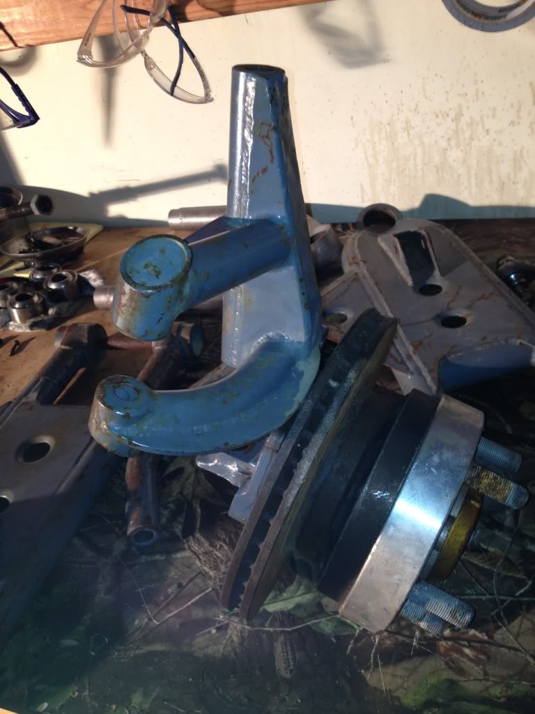

I need to extend the brakes out to make room for my bigger arms so this conversion look perfect.
I have custom race hubs from cone racing that are 3.5" wide od, on a stock modified 2wd spindle. do you think the hub id in the rotors you used can be turned to 3.5"? I'm also worried the rotor will be too thick and will interfere with my steering arm that is welded to my spindle. Does the backside of the rotor hang over the spindle at all?
see how close the stock rotor is to my steering gusset? I'm concerned the rotor you used will interfere. I can always clearance but am curious how much it protrudes if any.
My stock caliper hits the arm in the straight position so i'm in desperate need of caliper clearancing.

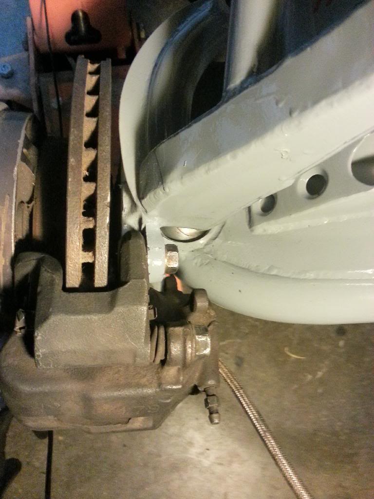

I have been using this post as my upgrade bible for the past few months. This is what I have so far.
1980 longbed 2wd SR5 w/4wd fenders/bed
Pre-runnered out with 2" Body Lift-3" lift Spindles and add a leaf's below (1983) 1 ton spings out back
31x10.5 Goodyears on 15x8 high offset rims with 1.5" spacer on back stock 1980 7.5" axle - 4.56 gears with TruTrac
Full 89-95 front suspension swap-less torsions(still 1980 stocks!)
For the brakes I have upgraded the OEM stock tiny stuff for something a little more appropriate for the big tires I'm running. I swapped in parts from a 1992 V6 1 ton truck, along with its dual diaphragm booster and 1" master cylinder. This thing (empty) will lock front tires and stops great. It's when I add weight (trailer) that I found they still need some more grunt.
I have Toyota P60 type calipers and the 1 ton rotor as described in these earlier posts by Gadgedizzle, a little bigger rotor at 10.1" and according to the manual 25mm thick. According to my findings on the net, the P66 Dual Rear Wheel Caliper has a bigger piston (2.621" vs 2.3xx") looks more ridged and is capable of a 30MM thick rotor - Only ~8mm larger in diamerter = insignificant. Stock type organic pads is all I could find for friction for the P60's. The P66 has more pads available and most importantly to me is BOLTS IN PLACE WITH WHAT I HAVE. The 4wd although cool and plentiful requires bracketry.
The issue is that I can not find a rebuilt set of these P60 calipers local, and with these being the rarest of the truck calipers I want to make sure I get the right ones and not have to ship things back.
What are the thoughts of using the P66 Dual rear wheel caliper in place of the P60 1 ton unit. ie: on paper it fits, but has anyone here tried? It is easier to find, and has more pad options-Ceramic would be AWESOME!
Also and chance any other trucks used the 10.1" size 5 lug 30MM disc?
Also is there a comparable rear disc set up for this? or should I invest in a universal adjustable proportioning valve and be done?
Face to face with a 4" suspension lift 94 4wd
New rims n tires
fresh install - 3" lift spindles P60 1 ton discs/calipers
P60 1 ton V6 caliper
Custom AN lines into P60 caliper - note spindle drop
Hope the eye candy was worth the pre read!
