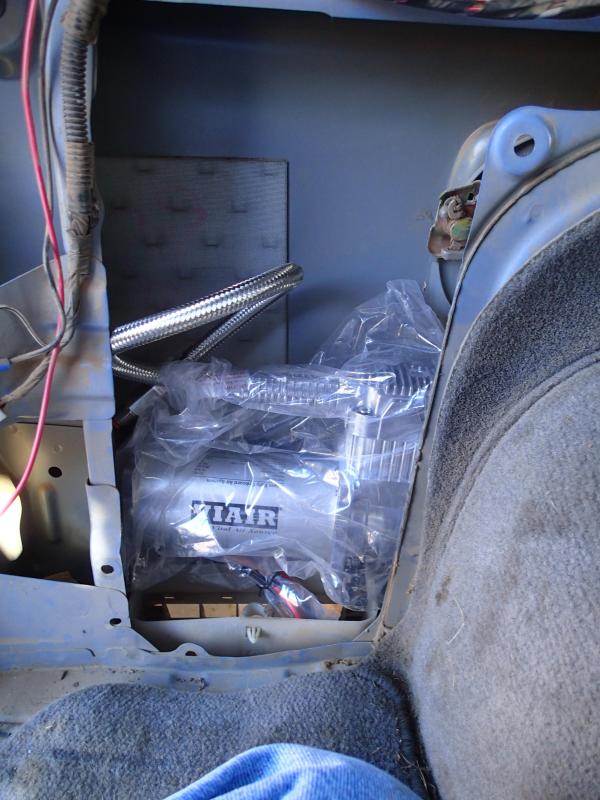

Here's where I'm thinking:
It does fit. Make a bracket to have it higher up than in the pic and I'm wondering just how structural the part towards the taillight that it butts up to is. I'd like to make a hole in it for a little bit more room, maybe reinforce it differently. I'd also like to put a desktop computer fan or two in there that switch on when it's on.
I could just cut out a place in the panel for air flow but it'd look nicer all tucked out of sight.
More later, in build thread. I've go to do some head scratchin'.
