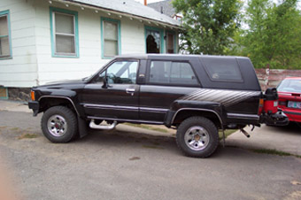

lost a lot of my height
Sad news,
Went out opening day of duck season, did a lot of off roading to get to secluded parts and while it handled very well I noticed on the way home my hwy vibrations were back!!
Also it is sitting quite a bit lower, I realize it would settle, but I was hoping it would be less than this.

I used blocks to level out the back of my 91 Pickup and it looks great. It's not going to settle which was the nice thing. I just picked the new height. While it won't make a HUGE difference in highway vibrations, it does make a difference. It changes the aerodynamics and changes different angles. Cheap too. About $35 for the blocks and another $35 or so for longer Ubolts.

I thought the consensus was blocks are a no-no because they can break off and att freeway speeds a break off could be deadly.
My truck sags about that much... How sad, you have way more weight in the back and still sit higher.

What breaks off on the blocks? Mine are Cast blocks, the things were at LEAST 6 or 7 lbs each. They didn't feel like something that would break.

I suspect that the U-Bolts are what are rumored to break. The longer they get between the top of the springs and the nuts, the more concered I would be, thats a lot of bending moment.
Unfortunetly in my case, I trimmed my U-bolts to fit this set up and I don't want to pay another 30+ bucks for more U-bolts and blocks. I still have better springs than before so I will just shut up and be happy with them.

as far as i understand ...blocks won't break .... but they would slide or get pushed out .... if you do alot of wheeling.
with the distance of the axle from the springs ... there is more leverage there... and underforce the blocks move. Lots of trucks use blocks ... some come stock with blocks and usually have a locating pin in the center to keep them in there.
you can use blocks ... just keep an eye on them.
but the trend these days is to avoid them altogether.

Well, as far as my blocks go... there is no possibility of sliding. There is a large pin on one side and a hole on the other. Can't remember the orientation. I believe the hole is on the bottom and fits over the pin on the leaf spring perch, then the pin on top fits inside the hole on the springs. Can't slide in any direction. I was a little wary until I got everything lined up and started putting it all together. The block kit I got was really well made. Of course I was given the u-bolts at first and had to go back to get the right one.(another NWOR screwup).
