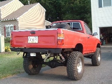

Rear Bumper
If you have a 2inch body lift, some 4x4 box and some 2x2 box will work great. Use the 2x2 for the legs to the frame, there are even some holes for you to bolt to in the frame. The 4x4 for the bumper cut on a 45 angle and cap it. If you want a flush fit, trim and bend the rear roll pan and tuck it under the tailgate. At least thats what I did. The pic does not show the new sides I have built for the bumper, they will go on soon.
hey i like the look of your bumper, did you cut out the bottom part of your box tho?
