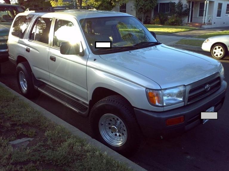

Hi, first post here. I am now the proud owner of a pristine 1998 4Runner and I have a few questions about it. Should I get this air intake? http://www.autoanything.com/air-inta...0A2646850.aspx My goal with getting the intake is to increase my MPG and maybe engine life ? I dont really care about more HP, I will mainly use the 4Runner to get to work and the occasional driving along dirt roads in the mountains to get to my hiking spots and fishing areas. Another question... Should I go full synthetic oil in a 98 4Runner ? Need help deciding on a part for my 4Runner.-9kufb.jpg
