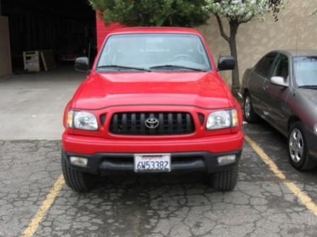

Have a 2002 Tacoma Ex Cab, V6, 5SPD
, 4x4, Diff Lock, TRD -- bought brand new in 2002 -- 75K miles. I occasionally carry a Six-Pac Cab-over camper that I also bought new in 2002 -- camper weighs about 1500 lbs dry. Additions to the truck to carry the camper have been: Michelin 10 ply tires capable of inflating to 80 pounds, 1 ton spring leafs on the rear, and rear air bags with a compressor under the hood for inflation -- otherwise it is all stock.

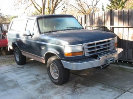

I also have a 1994 Ford Bronco I bought brand new in '93 -- has 234K on the rig with an overhauled engine and transmission about 60k ago. It also has a Warn M12000 winch that I would like to see if it would install neatly on the Tacoma -- I am going to sell the Bronco & keep the Tacoma.

  • Is there a bumper that would accomodate this winch?
  • If so, should I be looking at Schrock, TJM, ARB, Calmini, Armorology, Irbis, Rock-Tec, or others?
  • What do I need to do to the stock suspension to bring the rig level when the bumper and winch are installed? Looking for the best solution -- not climbing rocks, or things like that (I've already done all that when I was younger with the older Broncos & Land Cruisers -- Now it is just my wife and I going into the back country, using the camper for a base station for snowmobiling, backpacking, etc.
  • What about an extra battery or heavy duty output alternator -- ideas? -- Is it necessary?
  • Are there any other ideas I may or may not know to ask about?
I like my vehicles to be competent & capable, with a decent appearance -- so I'm not looking to do a radical change -- just want the peace of mind of having a winch when necessary. The Tacoma is an air bag equipped vehicle.

Wow, a M12000 huh.... that might be a tight fit for the pre-fab winch bumpers. I know my M8000 is a pretty tight fit into my TJM T-17.

Hey there Fred O. I have no experience with any of those bumpers. And I know you said you didn't want to have to listen to all the advertising hype. However, I think you mentioned some quality bumper makers and they would probably know better than the rest of us what their bumpers can fit. As far as the added weight on the front end I know of one simple solution that should work for you. http://toyteclifts.com/index.php?pag...mart&Itemid=53 And in my opinion, any time you are running a significant electrical load in addition to what the factory planned for it is a good idea to upgrade your system with either dual batteries or a larger alternator or both. Hope this is at least somewhat useful.

Your M12000 would probably be too large to for most of those bumpers. You should probably think about a special fab job if you are set on using the winch. Otherwise purchase something like an M8000..the bumper manufacturers should be able to tell you what they'll accommodate.
To accommodate the extra weight and power needed. Running a dual battery setup would be nice to have for your set up with the winch and all. You could also then use it to power other things while out camping with your wife. You can find battery isolator kits just about any where online. In terms of the weight, I'm a big fan of what Old Man Emu has to offer as mine have served me well. Depending on how much you are lifted in the rear, going with an OME 881 setup would be a minimum and would offer you about 1-2 " of lift. The OME 882 setup may in fact work even better as it is rated to hold loads of 240 or more...and would probably push you over 2" of lift somewhere. However it depends on the bumper and winch you go with. Also I don't know how much lift you have in the rear either so you may not like the look if you go more than rear is already.www.trdparts4u.com,4x4connection.com, etc. are good ones to find what you are looking for. I would also then suggest a differential drop for the front axle as well. These run about $40 bucks and you can get them from sonoransteel.com, toyteclifts.com offers them too I think. Just search around.

I know that the ARB and TJM bumpers can only accommodate a Warn winch up to 9500lbs. I see that you carry a heavy camper sometimes but I do think the 12000 lb-er is overkill for your vehicle. A snatch block with a 9000lb winch would be a better option for the rare event that you need such a large pull capacity.
Sell the 12 to someone with an F350 or a Ram and get a 9. Plus with the 9, a good heavy duty battery will work just fine on the electrical side of things, no need to upgrade the alternator or anything just for that.
