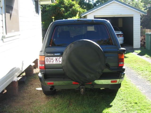

You could go the Hilux Surf route. I have seen similar mounts on the boards here.

Thanks AZ_98_4Runner, I'm definitely going to look into that if it's not too expensive. Can I ask you how the spare tire moves out of the way for the back hatch? That's a nice truck. Looks just like a 4runner.

It swings to the right side.

Yeah I found that out after some investigating. I like the look of the spare tire on the back but for me it's too much work and too much money. I'm okay with it under the truck too I just feel that a cable to hold it is not the best way. :/
