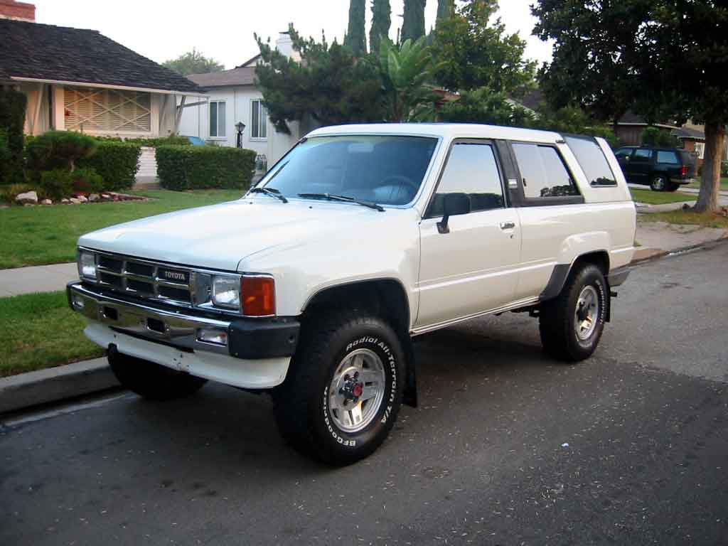

One small pic.
around 13mpg (but almost all the way was WOT with turbo, no cruise, no economy)
since then around 18mpg so far street driving

Old Aug 16, 2004 | 05:14 PM
seaflea's Avatar
Joined: Nov 2003
Posts: 1,571
From: wilmington nc
Sweeeeeeet.
man, that is clean.
