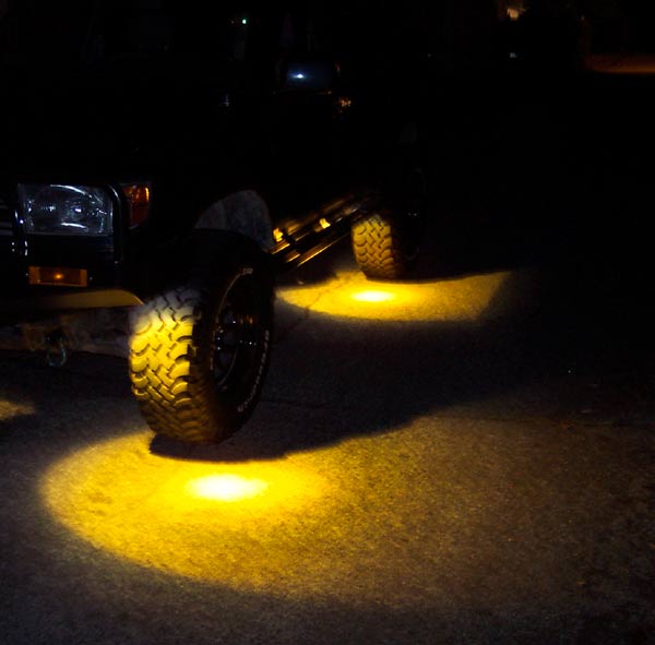

Rock lights... interesting....something like this?
https://www.yotatech.com/attachment....&postid=171084
Old Oct 24, 2003 | 07:52 AM
Churnd's Avatar
Joined: Jan 2003
Posts: 4,087
From: Hattiesburg, MS
Yes sir, that's the kind. Except I'd put them underneath the door. I have to admit when I saw your post on the lights, that's what made me want to do it.
