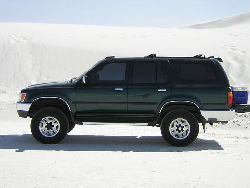

Here's the truck from the side. I am very close to 14.75" to level the front with the Downey HD in the rear. What you can't see is a lot of stuff in the back, a couple of kids, and a full tank. Normally the rear sits slightly higher than the front.
