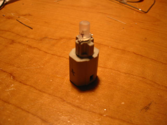

-there's a little grey bulb holder that confused me. I couldn't figure out how the bulb was held in. Ends up there's two thin flaps of plastic on either side that clip into the bulb as it slides in. Actually, the bulb's contacts are soldered to the two metal tabs you see sticking up. Anyway, pull the flaps out, pull the bulb out.
-break off the bulb's contacts, and slide the tabs back in, since they're the contacts for the holder.
-Solder the LED to the tabs sticking out the top. ***Mark on the bulb holder which side is the LED's + because I think this holder is reversible.***
-solder the resistor onto the wire harness coming from the dash.

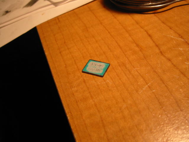

Ok, back window switch. pretty straight forward.
-take bulb out
-pop switch open
-replace bulb w/ LED/resistor combo
-pop label out and clean off adhesive
-I found that if you wetsand the back of the label VERY CAREFULLY, you can remove the layer of green. Don't try w/ a blade. Just try wetsanding it. I used 600 grit
-close it up and you're done!

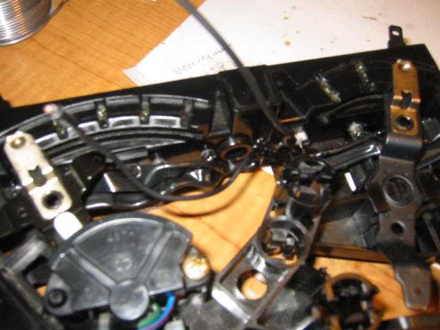

Ok, the A/C panel. This thing was a B!TCH to take out. I'm sure there's other ways to approach this, but after thinking the drilling the plastic thing, I thought the LEDs might be too close to the back of the panel to light it evenly, so I wanted to take the whole thing out and mount the LEDs directly to it.
*manual A/C controls* (not the new digital ones on the newer 3rd gens)
-there's two screws holding it in on either side. Really easy to see.
-unplug hardness on the back of the the fan-speed switch, and the white plug on the right side (I'm guessing it detects that you have the vents set on defog and turns on the A/C)
-A big clip holds the fan speed switch in on top. lift the clip, and slide the fan speed switch backwards.
-There's four wires that slide in and out of sleeves. There's clips on the A/C assembly that grab collars on the end of the sleeves.
-Spread both clips outwardsm and then pull the sleeve out. (shown in pic) *FYI, this step is the epitome of "easier said than done"* I found the easiest way was to take my swiss army knife pliers, stick them on the inside of the clips, and push into the collar, so that as the pliers go outwards around the collar, they open up the clips.
-unhook wire from the arm of the lever

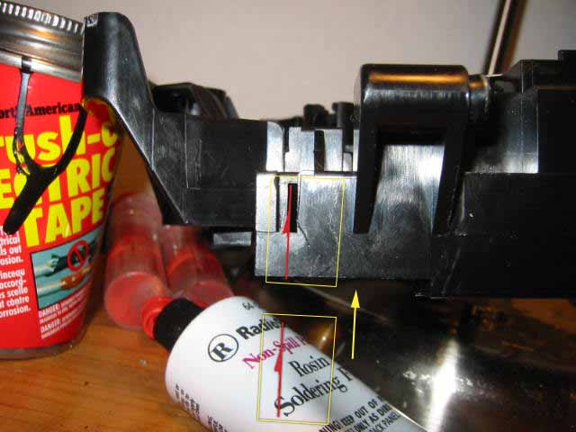

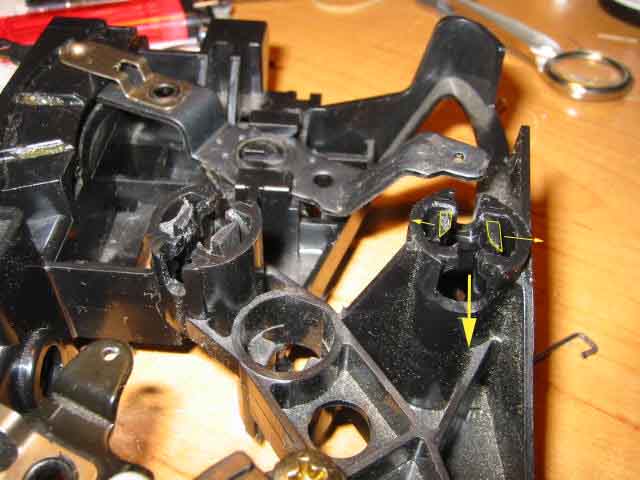

ok, now all that should be left is this pesky plug left that the A/C button plugs into.
I'm not sure exactly how this thing went in, but here's how I think it worked. It slides in from the bottom, as you can see the rails that it slides in on. There's these two pieces of plastic that run parallel to the rails that have the lockin triangle thing on them. You can get to the one on this side, but not the other because it's in a deep tiny hole.
So, to get this one out, I stuck a flathead in next to the side of the plug from underneath, twisted, and then used a whole bunch of brute force to get it out LoL.
Here's the picture of how I think it works. the plug is in yellow, rail and lock in red. *the picture is actually wrong for the plug shape as the plug is longer sideways than it is vertical, but that doesn't matter too much.*

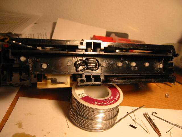

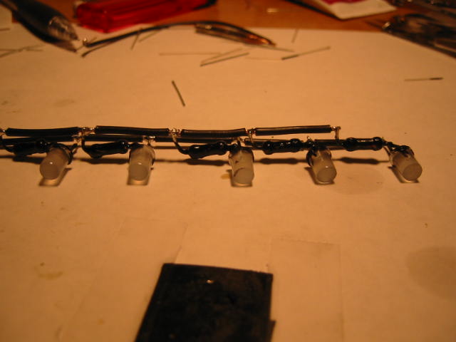

I basically did the same thing, except I just wanted to work at my table instead of in the truck How did you you insert all the LEDs though? there's a bunch of crap back there that would get in the way and would make it really tough to do in the truck.

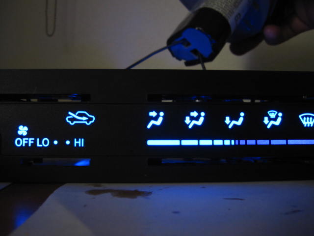

Ok, A/C panel
-first, I dremeled out the two "barriers" inside the lighting area. I figured they would get in the way of the light dispersion. *edit* you can see above in Bill's picture the barriers I'm talking about. One is on the left side to the right of the left-most LED. The other is on the right side above and below the right-most LED.
-then marked and drilled 3/16" holes for the LEDs.
-Flattened the heads of all the LEDs I would be using.
-soldered resistors to all, and then soldered all of them in parallel.
right side

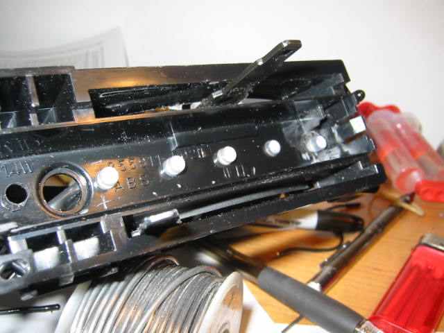

-I also wrapped them in regular electrical tape, just in case since there's the moving arms above and below the wires.
right side installed

From: LA, CA
testing... lookin good!

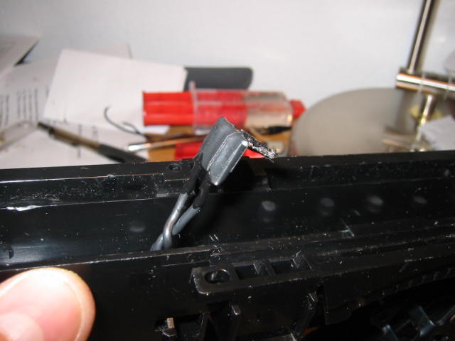

I made a thingy to plug into the bulb socket.
it's a really thin piece of plexi glass with two of the cut off LED legs sunk into it, and then bent 90 degrees out the back. I used the plexi to hold the legs in position so that I could solder the pieces of wire that would be my contacts. I did it the same way I described earlier of making Us with wire and soldering them.
