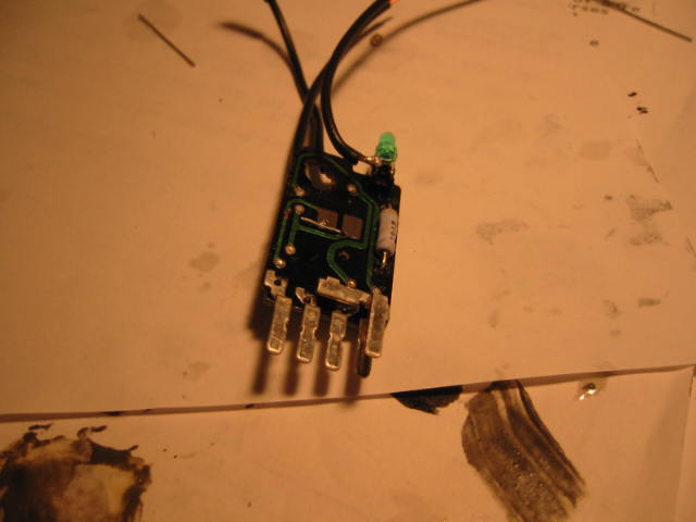

Ok, A/C switch.
-I soldered little wires to the contacts to test them. Ok, I got my digcam back so I'll snap some pics. In this pic, the bulb contacts are in the upper right of the board. the right side is +, left side is -.
Old May 24, 2003 | 04:55 PM
  #53
DuB's Avatar
DuB
Joined: May 2002
Posts: 402
From: LA, CA
in this pic, the LED's + is the left leg, and the - is the right one. It's reads about 2v with the parkign lights on, like 2.2v or so w/ the lights off.

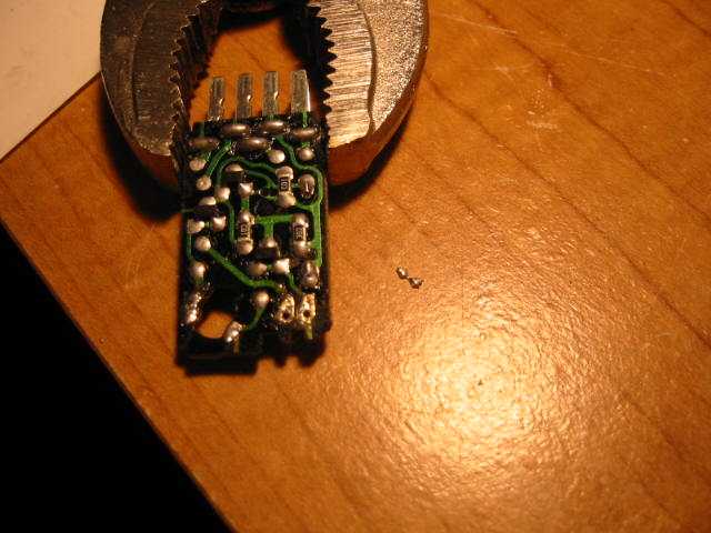

Old May 24, 2003 | 05:19 PM
  #54
DuB's Avatar
DuB
Joined: May 2002
Posts: 402
From: LA, CA
I worked on the LED first.
-unsolder the LED. Heat up both pads and pull the LED from the other side.
-To clean the holes, I heated both pads up, and then smacked the wrench/PCB board combo against the table. Inertia ought to cause the solder to slide right out You can see the two dots of solder in this pic.

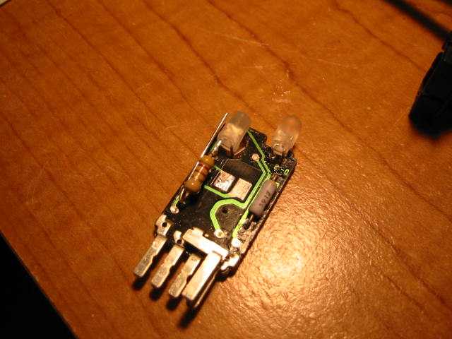

Old May 24, 2003 | 06:21 PM
  #56
DuB's Avatar
DuB
Joined: May 2002
Posts: 402
From: LA, CA
DAMNIT. I had buncha stuff written up, but file was too big and erased my text.
-Anyway, bend the legs of the resistor 90 _at_the_base_. It turns out that it makes the LED just the right length and height this way.
-cut the legs to length
-insert in the board and solder in.
you can see the LED in the upper right of this pic.
The other LED took a bit of creativity. There's no room in the space inside the switch for the resistor, so it has to go on a little space on the outside of it. You might be able to figure out your own solution, but this is how I did mine.
-bend the - leg straight down again and soldered it in place.
-notch the plastic of the switch to let the + leg of the LED slide through.
-solder the resistor on. You can see how I did it in the picture.
-bend the resistor leg back under the resistor. The idea is to have it pass directly under the other leg so that it slides in the same notch in the plastic.
-bend through the hole and solder to the pad.
You can see in this picture that I flattened the tip of the LED that replaced the bulb, and I left the LED that replaced the stock green LED round.

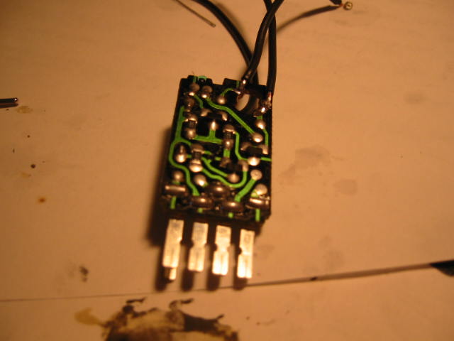

Old May 24, 2003 | 06:24 PM
  #57
DuB's Avatar
DuB
Joined: May 2002
Posts: 402
From: LA, CA
This is a bad picture, but if you look really closely, you can see the resistor. There's a bunch of black gunk all over the resistor and its legs which is some paint on electrical "tape" I borrow from my friend. Well, this picture is mostly to show you the little space on the "outside" of the switch.
Old May 24, 2003 | 06:55 PM
  #58
Cebby's Avatar
Joined: Sep 2002
Posts: 11,199
From: Pittsburgh, PA
There is something called "Desoldering Braid" that you put on top of the solder you want to remove and heat with a soldering iron. The solder wicks out into the braid leaving a nice clean area for resoldering.
You can get it at RS.
Old May 24, 2003 | 06:56 PM
