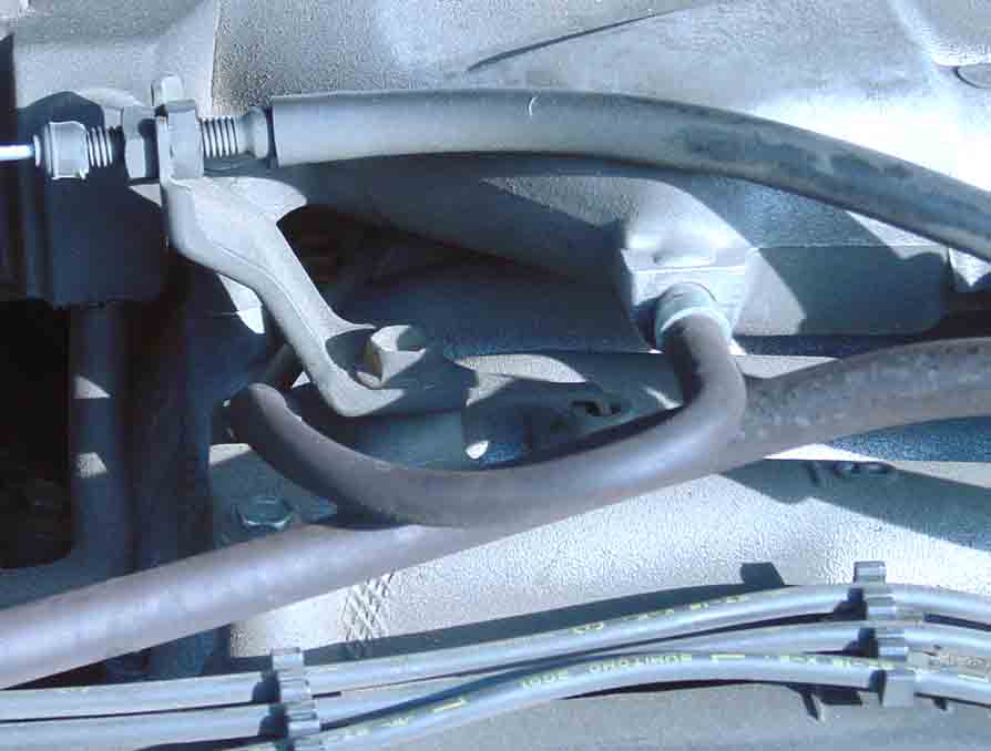

Here is a picture of the mod on a 2001 3.4L engine. Note the difference on the FPR hose routing.

Here is a better close up of the FPR hose routed into the manifold.
