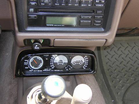

I flip flopped on how to mount it on the dash but there was no easy way without a bracket on the bottom (no easy way that is). I mounted it to the front of my floor console angled up at close to 15 degrees. Let me know what you guys think.

Cool!
Hey it works, only problem is you have to look down to see it.

Looks great. I snagged mine out of a junkyard.

I mounted mine to the plastic cover behind it. It had a shelf built in it but when you remove that plastic from behind you can see it uses 3 self tapping screws to hold the shelf on. I used those to hold the back cover of the inclinometer. I was able to measure it very carefully so that the 3 screws lined up and the bottom of the inclinometer is being supported by the shifter console.
Mine didn't come with the metal base so I think it is lighter and is supported well. It may not work so good with that metal base. I was going to use a piece of angle iron screwed into the bottom of the inclinometer and then screwed to the shifter console but this worked out better I think. I can remove the front of the inclinometer with 2 screws, I have quick electrical disconnects for the wiring. Because of this I was able to follow Roger Brown's directions to get the full movement of the gauges.

Looks good. What color is the illumination?

Its the same green that matches my dash.
