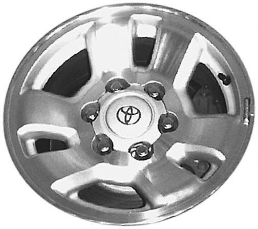

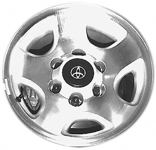

the rims I'm getting are from a 1998 Landcruiser...how much backspacing is there on these rims? How much backspacing does my current 4 runner rim have?
my current 4 runner rims are 16" and look like this:
the rims I am getting are 16" and look like this:

The stock 4Runner wheels have a BS of 4.75" while the LC80 wheels have a BS of 4.25"

The land cruiser wheel you are showing is from an 80 series cruiser for which 1997 was the last year of production. the 1998 (100 series) cruisers have a 17'' wheel.

Yea...and the 100 series cruisers are 5 lug. Your 4Runner is 6 lug. Not gonna work.

I have them on my 4Runner. I have bushwacker fender flares and they are about flush with the outside of the tire.
They are also 8" rims, which gives a bit wider stance.
