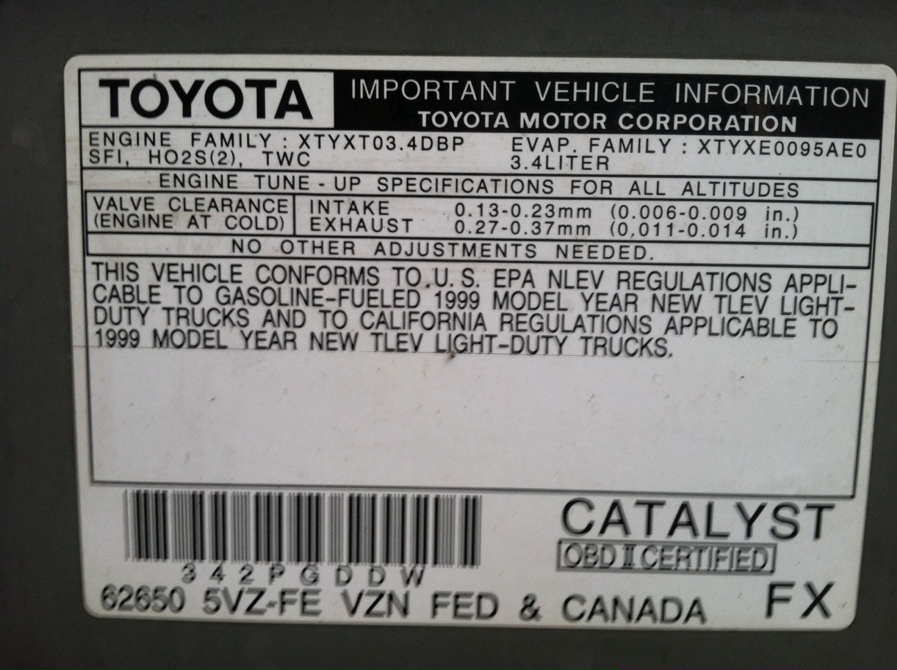

MAF sensors are the same. The front O2 is a wideband air/fuel sensor, the cats are different, and the engine ECU is different--that's about it. If you feed a federal front O2 sensor signal that is totally different electrically into a Cali. ECU I would think you would get a lot more codes than p0171. I can't imagine the engine would run well at all, or even get into closed loop. Is the ECU original? Is this hack-up recent, as far as you can tell? Finally, are you absolutely sure the truck was born a Cali.? Could we see a pic of the emissions sticker under the hood?...They can be confusing.
Here is a pic of the emissions sticker. I'm pretty sure it's california although I don't understand why it says Fed & Canada at the bottom.

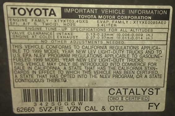

That's not a Cali vehicle. My 99 has CAL & OTC instead of FED & CANADA at the bottom, and there's more text in the main box.
Attached Thumbnails Illegal Modifications?-screen-shot-2013-06-20-09.30.39-.jpg
What he said, and what I suspected. There was no way that truck would run well with a mismatch between ECU and front O2 sensor. As I said, those labels can be confusing. P0171 is a pain to isolate, but at least you aren't chasing ghosts.
I'm amazed I didn't see the label before, but you posted it exactly at the same time as my last post.
