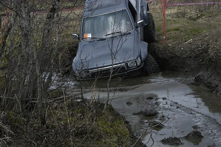

Like this?
You might contact user: Belize Off Road Team as they posed this pic 02-16-08 and might be able to help.
Also, you might try searching under "Hilux" or "Surf" as opposed to "4Runner". The Scandinavians and Europeans as well as the Australians seem to have lines on things like this.

Replied to your PM, if no luck finding them in Japan, then i know for sure that Arctic Trucks out of the great white north will either sell them or make them, either way they will be your best bet.

Do you one better:
http://www.weds.co.jp/english/export.html
that is the contact info for the company that owns that white Surf posted earlier. Contact them and ask them what brand those wheels arch flares are.

Nice searching BORT!
Second one down in the above link is perfect as it is for the surfs and is a 6 piece kit which suggests that it accomodates the rear door piece and would be ideal for your needs.

i personally love the "north pole" flares, massive flares for the mk2 hilux will fit the surf with minor modification to the rear flares.

On the 3rd gen 4Runner, any "pick up" aka "Tacoma" aka "Hilux" flares will need more than "minor modification" to fit a 4Runner. Part of the single rear pick up flare needs to mount to the door and part need to mount to the rear panel. In other words, each 1 piece rear pick up flare would need to be cut in two. Once you do that, it wouldn't be simple to mount to the door since fender flares are hallow. I am not saying that it can't be done but it would be tricky. Also keep in mind that the front fenders on the 96+ 4Runner are unique to the pick ups also. From 96 on, the 4Runner has front fenders different to the Tacoma and Hilux. All 3 vehicle have totally unique bodies now.
For the 90-95 4Runners, we can special order the JDM style fender flares for anyone that needs them.
