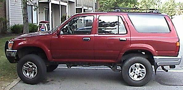

Heres a pic after the install WOO WOO. gonna get bigger tires as soon as i put on some downey hd springs to level the back up.
