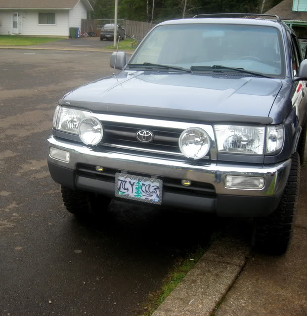

one reason i didn't get one of them giant bug deflectors but i got this lund avenger its enough to help the front end look a little better
