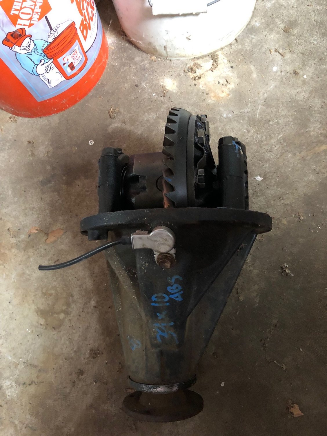

I believe autos have a different ratio than M'T because the trans has a different final drive ratio. I have a 3rd in Frederick, MD that you could borrow if you want to rebuild yours. It's 39x10 RxP so that should be your 3.91. It has the plug for ABS, but as you can see in the picture it's cut off and worked just fine in my 4R. This is my spare, it doesn't match my front ratio, in case my rear goes and I need to keep driving while I service my original.

my spare does NOT have the elocker. It has the ABS sensor, but as you can see in the picture it is cut and worked just fine like that. My 4Runner uses sensors on the axle shafts near the hubs.
You’re welcome to borrow it. I go to Kings Dominion regularly so we could possibly meet up.
Your ring and pinion should be 43x11 or 3.909 (3.91). Mine is 39x10 so 3.9. You would get a very slight bark in 4wd if you used it on pavement, on dirt I think you would have enough slip.

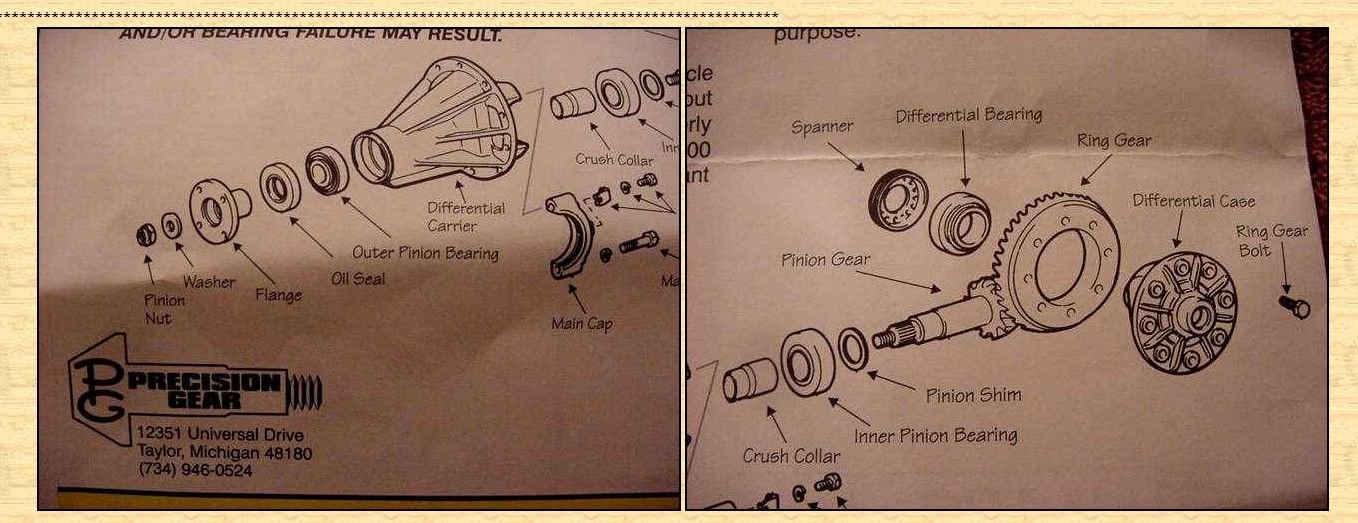

Well, if it's for the ring gear......the ring gear bolts to the center case. Sometimes just called a case. Inside the case are the side gears and spiders. The mechanic really was not very specific what the bad component was......

Old Aug 1, 2022 | 04:38 PM
ZUK's Avatar
ZUK
Joined: Oct 2003
Posts: 1,858
Likes: 28
From: Prescott AZ
Old Aug 1, 2022 | 07:56 PM
millball's Avatar
Joined: Aug 2013
Posts: 4,264
Likes: 683
From: Southern Arizona
Case ====== Also commonly known as the differential carrier.
