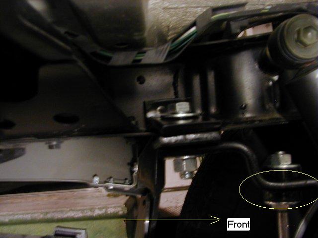

Both brackets face the same direction: toward the front, parallel to the frame.
I circled the part of the bracket facing the front.

Cool.. thanks a lot for the pics.. they help more than any directions.
The instructions pretty clearly say that they'll be facing different directions but it did not make sense at all
on the passenger side.. where do you have the long bolt going? between the exhaust and leaf springs?

Here's what I'd suggest:
Drop the spare so you'll have room to work.
Assemble the whole thing, and start by attaching the U bolts to axle, this will position every thing. (Tighten the nut on the end links just to the point the bushings start to bulge.) Once the U bolts are on, you will see that the pinch brackets are only going to meet the frame in a certain spot. Adjust the bar up or down to move the pinch bracket forward or back so you get maxium bite on the frame.
Yes, the end link on the passenger side goes between the leaf spring and the tail pipe
Hope this makes sense...
