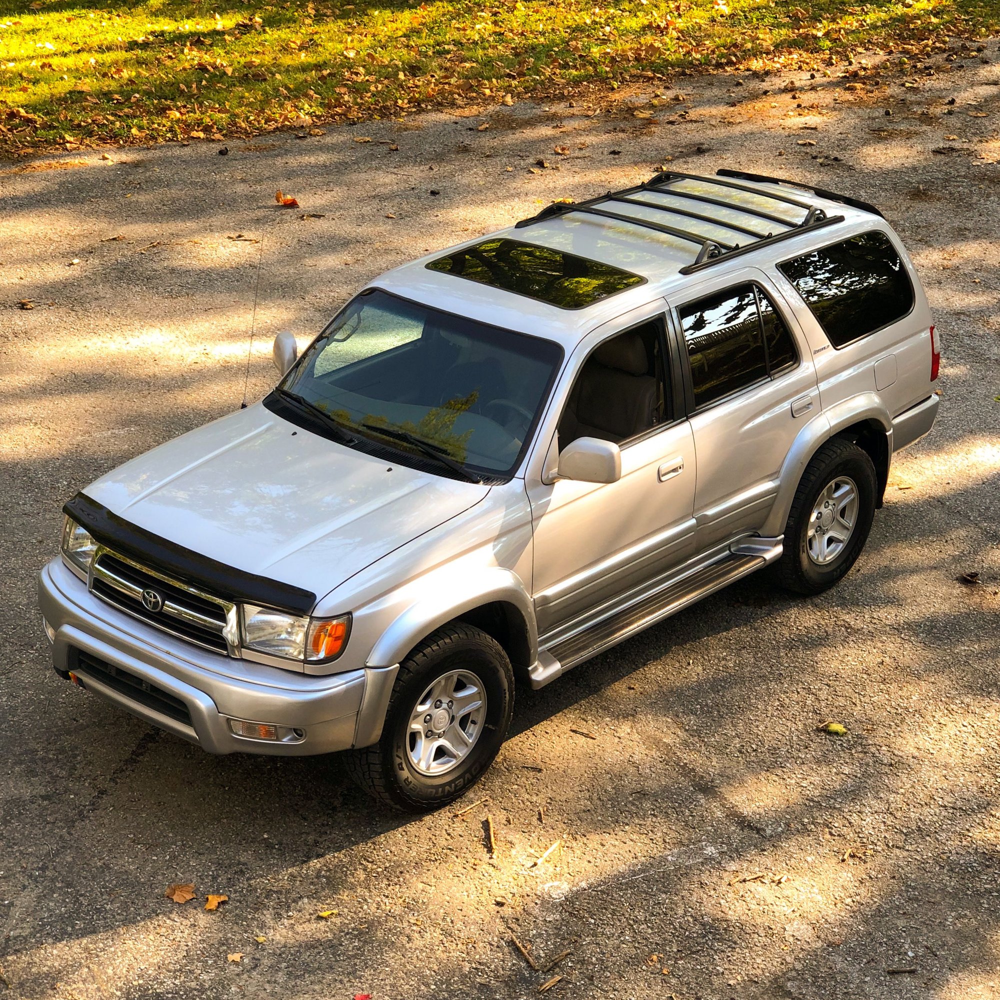

Total noob here, folks!
Just picked up a 2000 limited with 137K on the clock...I am an old school square body guy, but I spent some time in Kenya earlier this year and gained a mad respect for these Cylon faced sleds...
She's gonna be a daily for the next 6 months or 2, so I am not goin crazy on upgrades just yet...
I'm puttin new bumpy parts on her in the form of Bilstein 4600s...my question is about rear springs....I know, I Know, there are thousands of posts about this, but I specifically want to ask if anyone has used the Duralast (Auto Zone) replacement shocks...
I've seen everyone saying to go with the 99 tall shocks, but 99 and 2000 springs share the same part number, soooooo...I have a set of OME 906s (took a while to figure out the 906s and 2906s are the same thing) but I am concerned about having an 80's, pumped to the max, air shock lookin rake...oh and I'm not changing out the front springs just yet...
Duralast...anybody used them??
Thank ya all...

Nice looking 4Runner.
