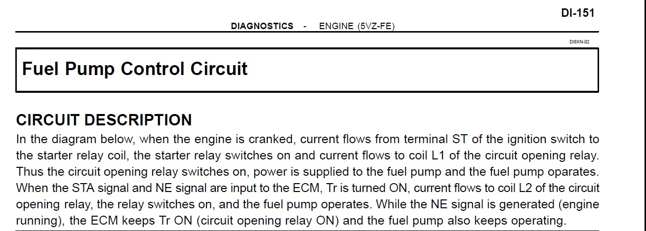

From what I know the pump should only be pumping once you are cranking. It does not prime. Are you sure you have all the sensors hooked up? MAF, Crank and Cam position sensors?
Edit: I don't know what book you have but the Toyota FSM says:
Attached Thumbnails Help: 96 4Runner won't stay running..-fuel-pump-when-cranking-running-only-fsm.jpg

Could be..? You say "new motor" what is it? Same year? Did you use donor motor sensors or originals?
