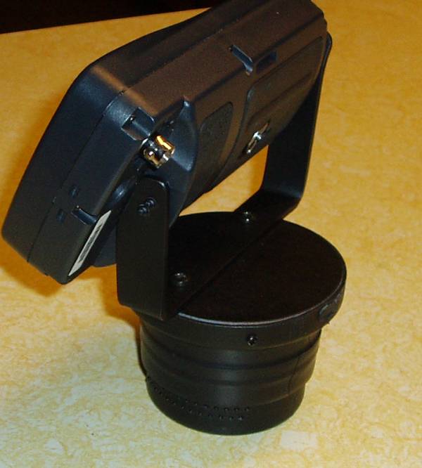

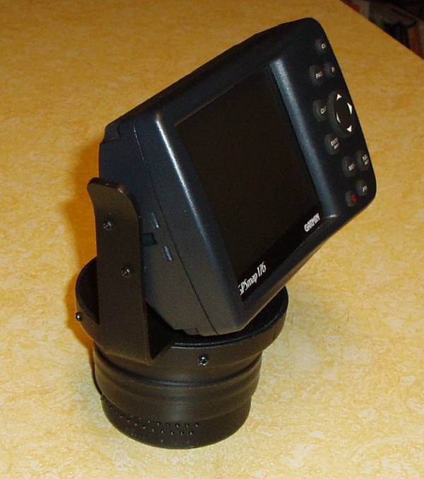

I just made myself a mount for my GPS that will work in both of my trucks.
I used a piece of 1/8" x 1" aluminum flat bar that I had laying around. I used the dremel to cut off and then grind smooth 4 small screws that fit into the little holes (in this particular unit - yours may vary) and bent the flat bar to cradle the unit the way the $60 factory brackets do. Note that the screws do NOT screw into the GPS, after I screwed them through the aluminum I ground them off so they are just pegs.
Then I cut off a plastic travel mug. I cut a wood plug to fit into the top of it and screwed the "mug" to it, then screwed the aluminum bracket to it.
Then I painted the whole thing flat black.
Then I wrapped the "mug" with layers of foam tape (camper tape I had laying around, cut narrower with a razor blade) to make it multiple sized and snug fitting in the cup holders of both my trucks. (Didn't want it bouncing around.) I then wrapped the foam tape with black electrical tape so it would last longer.
It fits snug in the cupholder in the Yota and the F150. I use a 12v cord. Works great. I also have a magnetic external antenna but it works fine without it.
Cost: $0.00 I had everything I needed already. (As long as the GF doesn't go looking for her purple travel mug...)
