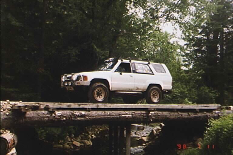

In your not too concerned with limit articulation... Rancho used to make a bolt on "trac arm"... It slung a loong (50"?) tube from under the axle to the frame rail.
(its on the 4Runner in the Avatar)
Since the arm was long the change in length as the suspension cycled was low.
But the bushings limited cross articulation
Hmm - new Rancho website has NO Toyota stuff?
Its a cheezy scan...
The bar is barely visible
The frame mount point is under the drivers door somewhere..
