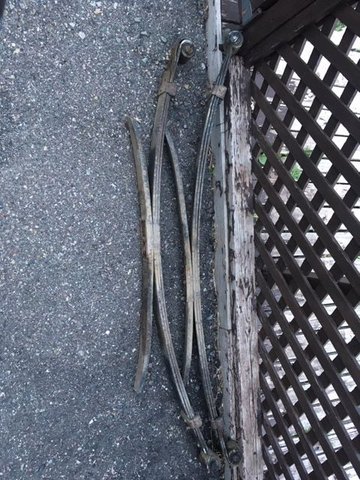

New leaf springs and rear shocks are on the truck. I drove around town a little, and wow! When I bought the truck about 4 years ago the leaf springs were shot, but I put new shocks on plus air bags. I knew it rode a bit rough, but I was also expecting the HD leaf springs to be pretty rough. No comparison. All the little bumps I felt on the road aren't even there anymore. I'm really, really happy with the results so far.
The driveway I'm parked in doesn't have much space so I couldn't get great photos, but here's how it sits. I'm guessing and hoping it'll mellow out a little over time (and probably a bit right away once I hook up my trailer), but whatever. I like it.
Hard to get good photos of leaf springs once the tires are back on...
