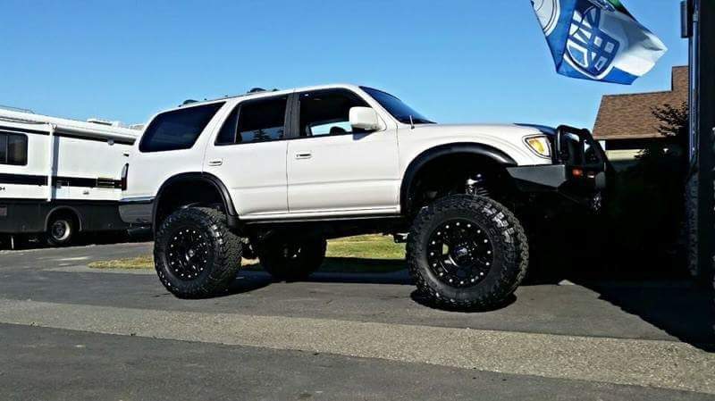

97 runner fj coils in back fabtech 6" front with total chaos uca
