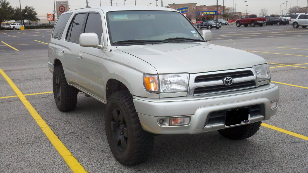

Here is mine on FJ steelies with 255/75/17 bfg muds. This is before the lift. The only rub I would get was coming into a driveway every once in a while. Im thinking of swapping to different FJ wheels with 285s now that I have SS lift.

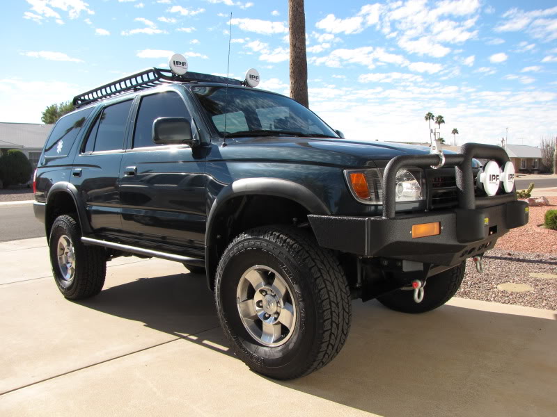

Originally Posted by 4runnerFireman
Here's my 99 with 2010 4runner wheels if anyone wants to use it as reference??!! No spacer, no problem. I just put brand new 275/70/17 BFG AT's on it a couple days ago, I'll try to take some pics soon!! The tires in this pic are my old worn down 265/70/17's. The 275's are AWESOME, but it did make the truck a little less peppy cause of the gearing. But, for those of you guys that are not big enough for 285's, the 275's are a very good substitute.
285/70/17 = 32.8"
275/70/17 = 32.2"
Stock 265/70/16 = 30.7"
Rock on!!

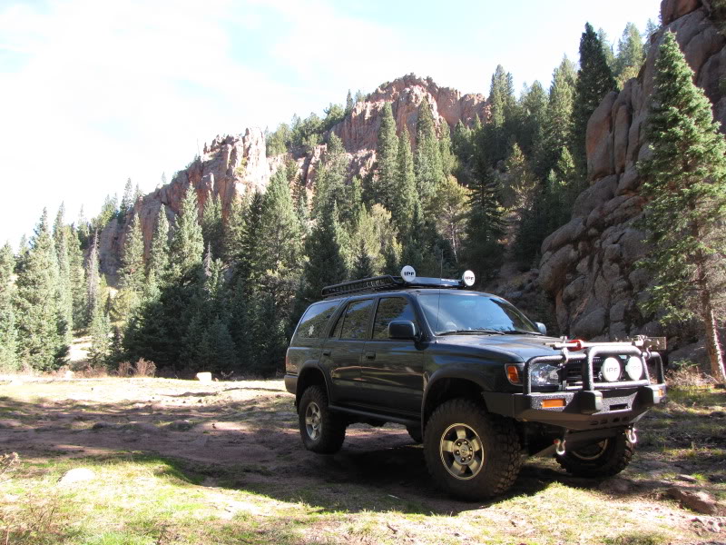

Hey Doug I just put a set of some 255/75/17 BFG Muds on my runner and I love them! They are taller than the 265s but don't feel as heavy plus they just look so much better. Here is a cell phone pic but I will get a better one tomorrow. I picked up 5 of them brand new for $400, cant beat that! Post up some pics of your rig with the new wheels

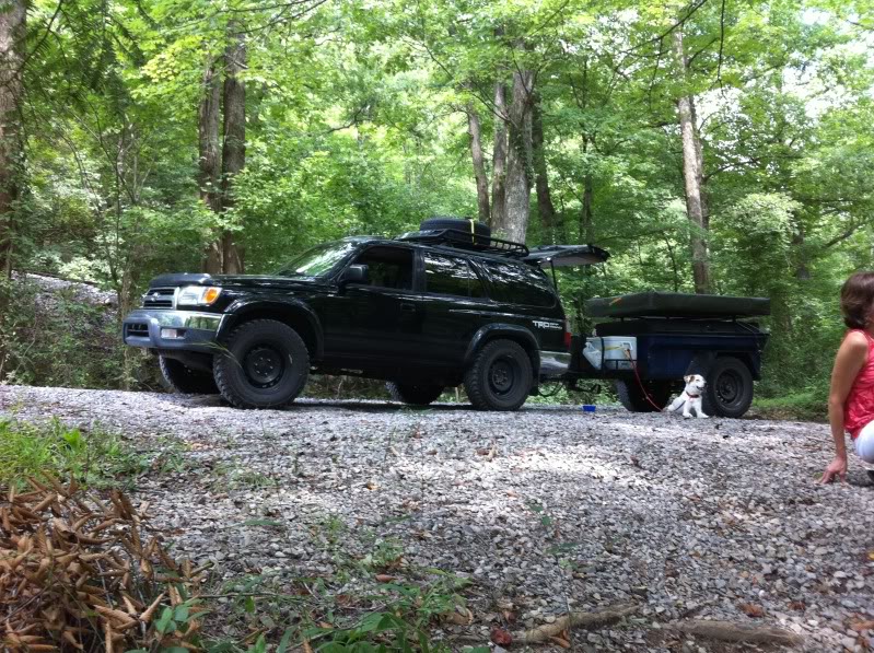

Yeah they look pretty awesome, especially when you get rid of the gay tires Toyota put on FJs from the factory.

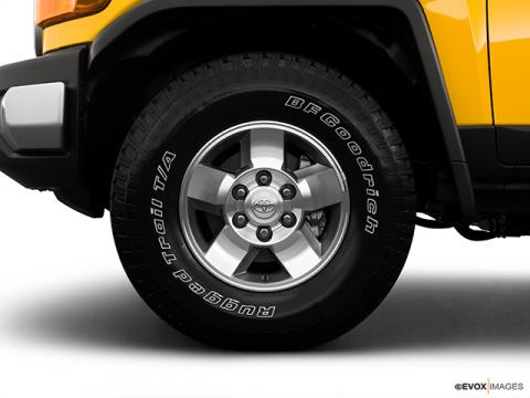

Does anyone have these ones on a 3rd gen 4runner?

FJ wheels and 4runner wheels are all going to be either 15 or 30 mm back spacing which is about a .35" difference so not much. Most of the stock wheel specs are available on the TRD site.
