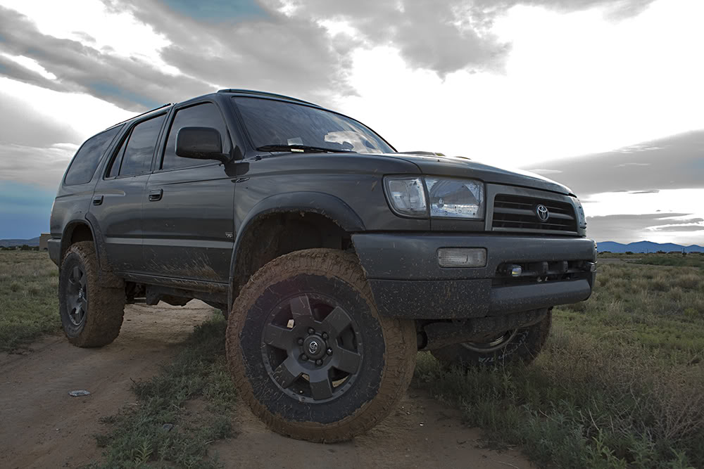

Originally Posted by mastacox
Ta da!
Mastacox's 1998 4Runner SR5
Keep in mind their backspacing is larger than stock (4.84" vs. 4.625") so if you want to run anything larger than 265's you'll need wheel spacers. I'm running 285x70r17's with custom 3/4" wheel spacers.
Wow these look awesome on your 4runner. Are they black or a dark gray? I can't tell cause they are dirty lol

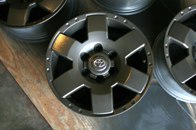

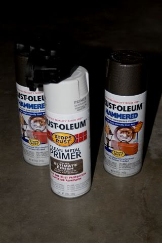

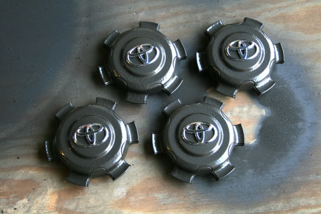

Old Nov 1, 2010 | 11:14 AM
  #39
mastacox's Avatar
Joined: Dec 2003
Posts: 2,893
From: Fort Worth, TX
The color is Rustoleum "Hammered Finish" Dark Bronze. The color turned out very similar to my 4Runner's factory anthracite color.
