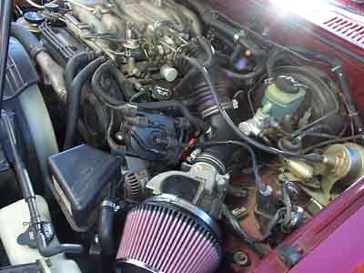

PICs of installation. Notice the ground wire kit? (top of pic).........Well ISR mod seemed a little too advanced for me. Nevertheless I am happy with the FIPK. Is THere a supercharger for 3.0 I didnt think there was..but if so.....PLEASE let me know...

Hehehe, looks just like the FIPK in my engine bay.
Peeps are correct about the FIPK in the 3.4L - it lost 1hp on the dyno - on this engine it makes a BIG difference though. If you couple the ISR mod with the cone filter, you have a cheaper FIPK, but I like mine.
