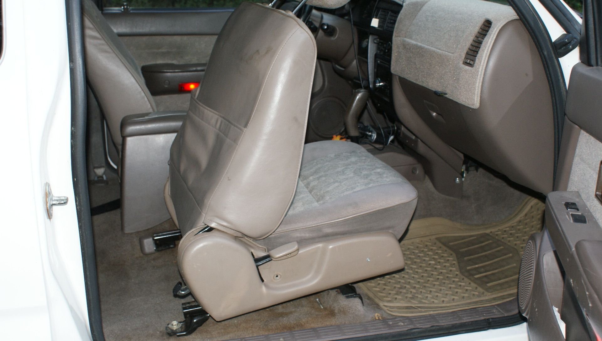

Sunday was install day, Humid as all heck, but a Mans gotta do what a Mans gotta do
Old Aug 23, 2019 | 06:41 AM
KdF's Avatar
KdF
Joined: Sep 2007
Posts: 74
From: Big Sandy, Texas

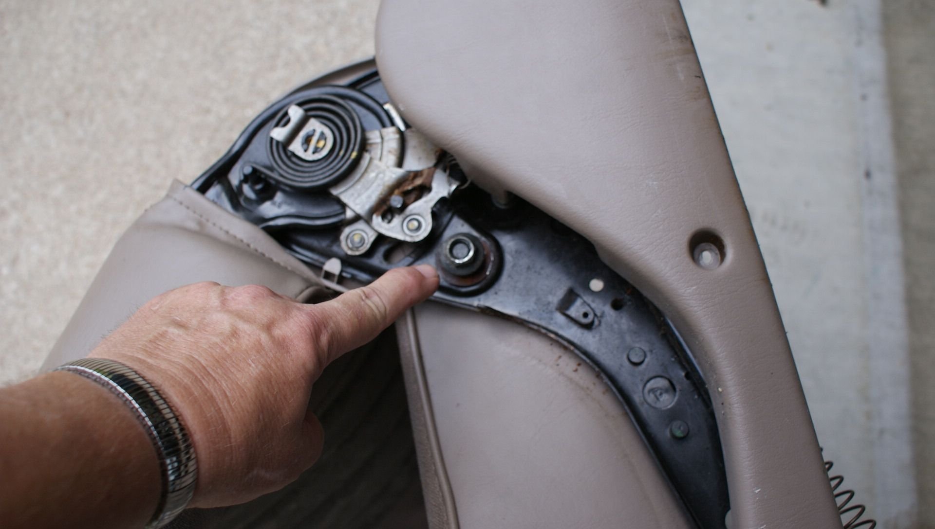

Out with the Old. This one has a broken back, you could sit in it fine, just never adjust it or BOOM. Also I did this side 1st in case I ran into trouble or my back gave out, and I would still be able to drive it.
