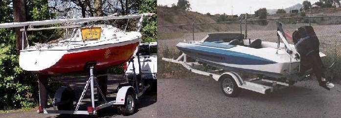

Towed this sailboat and this ski boat with my 85 with a 22RE. Couple hundred miles sometimes. No worries.
