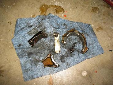

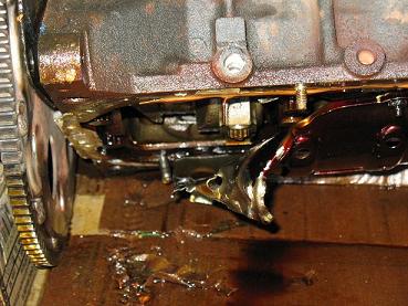

Skrillah, broke a rod and shot the bearing cap through my bottom end. Per your request:
Engine Swap Complete But W/ Problems-img_0337.jpg
Engine Swap Complete But W/ Problems-img_0339.jpg

Originally Posted by MattNuge
Hmm, I'll try re-checking all the lines, hopefully that works.
Attachment 69529
Attachment 69530
wow. last time I seen something like that was some punkz trying
to go through a puddle and forgot the puddle was 6 foot deep. engine drank
water and promptly grenaded
Attachment 69529
Attachment 69530
Ouch...
Attachment 69529
Attachment 69530
Graphic. How many miles on it when that happened>?

Skrillah- 116K on old motor... yeah, just a baby, something that made me go hmm. Check all fluids before I left for Christmas, driving up a grade and the BOOM, that was the end of that. I'm guessing my oil pump malfunctioned and all hell broke loose.
