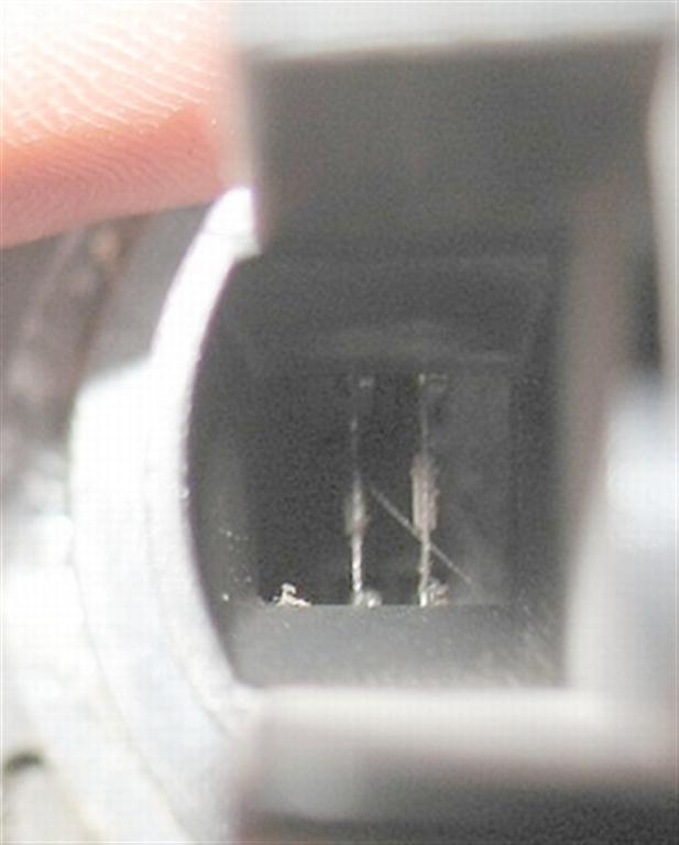

Okay that was quick and easy. I used Carb cleaner and some compressed air. Here is the picture of what it looked like before - what do you think? Notice the dog hair? I reset the ECU. Lets see what happens. Okay now who has a nice 30 minute fix for about 50 HP?

You really should have used brake cleaner like I mentioned because carb cleaner leaves an oily residue which can coat the wires and will bake itself on when the wires heat up (eventually it may force you to replace the MAF). You probably didn't kill the MAF by doing this but next time don't use anything that leaves a residue when it dries. You might want to buy some brake cleaner anyway and just clean it a second time to be sure it has been thoroughly degreased.

Fair enough, I'll redo it. I'm not driving it anyways for the week. Thanks for the input - what did you think of the MAF - it was hard to see if it was dirty until I brightened the picture up.

The MAF was definately dirty!
Those wires should be nice and shiny clean.

mmm the after math of what a k&n filter does
