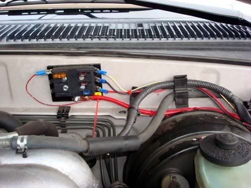

On the left side, we will attach the second assembly but this time we will attach one lead to one of the wires coming from the right side assembly. The second wire of our left side assembly will attach to the wire that was run through the hood bracing to the firewall. When completed, you will have two wires exiting the lower hole of the hood bracing.
One wire will have a female spade connector crimped to it for connection to the hot side of a 12 vdc supply source. In this install I have an Auxiliary fuse panel installed so this will be used as our power source.
The second wire will connect to the wire routed through the fender channel to our switch. This is the Ground path. Using a piece of split loom, cover the wire bundle coming from the hood. Use enough so that part of the loom will install into the hood bracing. Tape the ends.
Install a 5 amp fuse in the Auxilary fuse panel and if all is connected correctly, then you should have lights!
Test operation of the switch by simply pressing down on it. Next item is to close the hood and latch it. I had some issues with initial closing of the hood as it crimped down on the wires at the base of the hood. I am trying to locate a rubber plug that I can install to keep the wire and loom from slipping out of position.
If you have located and adjusted the hood switch properly the when the hood is fully closed and latched, the engine bay lights should be out. If this is not the case, you will need to remove the securing nut, disconnect the switch from the wire and add another washer to the switch to raise its height.

Definitely on my "To Be Done List" Where did you find the extra fuse box mounted on the firewall?
Old Dec 14, 2009 | 06:55 AM
Ritzy4Runner's Avatar
Joined: May 2006
Posts: 979
Likes: 13
From: Shelton, WA
Pretty much any local parts store should carry the aux fuse panel. I got mine from Auto Zone. I believe it was around $5. This is what it looks like installed
I located it on the firewall just to the left of the power brakes master cylinder (left as you are looking at it). Really simple install, mount to the firewall, run a length of 8 gauge power wire from the panel along the lower edge of the firewall over along the fender well to the battery terminal, crimp on lug that can be attached to the positive terminal clamp and the panel is hot. There are some install write ups you can also check.
