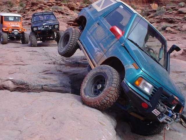

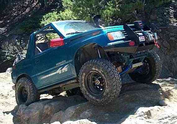

Hey, my rig is at least a Truck or an SUV, or something.
1995 Suzuki Sidekick, 2-door soft-top.
Geez, mods...
Calmini 6" combo lift (3" suspension, 3" body).
Calmini Anvil - Steel front diff housing (stock is aluminum).
4.24:1 lo range (1.8:1 is stock)
5.83:1 R&P's (5.125:1 is stock)
ARB's front & rear.
Calmini steel winch bumper, Warn M6000 (more than enough for a 2500 pound rig)...
etc.
Second Generation 4Runner CV axles - there's a guy in Wisconsin making adapters to put Toy axles in Sidekicks. The Runner axle is about twice as heavy as the stock Suzuki axle. Very good mod! (I grenaded two stock CV axles in Pritchett Canyon, at Moab this year).

I try to wheel (whenever I can) with the Rising Sun Toyota club here in Denver. Great group, and they have been surprised what a little IFS Kick can do on 31's. My next upgrade will be 33's - but the Sawzall's gonna have to come out for that mod - again...

Here ya go - Moab Rim:
