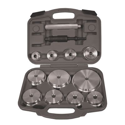

I didn't need a press when I did my axle seals...just freeze them (seriously) and buy a $20 seal tap kit. They'll go right in.

i like the freeze idea. where i would i get this saidseal tap kit? harbor frieght? or autozone?

I got mine at Checker/Schucks Auto Supply, but I'm sure Autzone has them too. They sort of look like this, only much, much cheaper. Same idea though...
