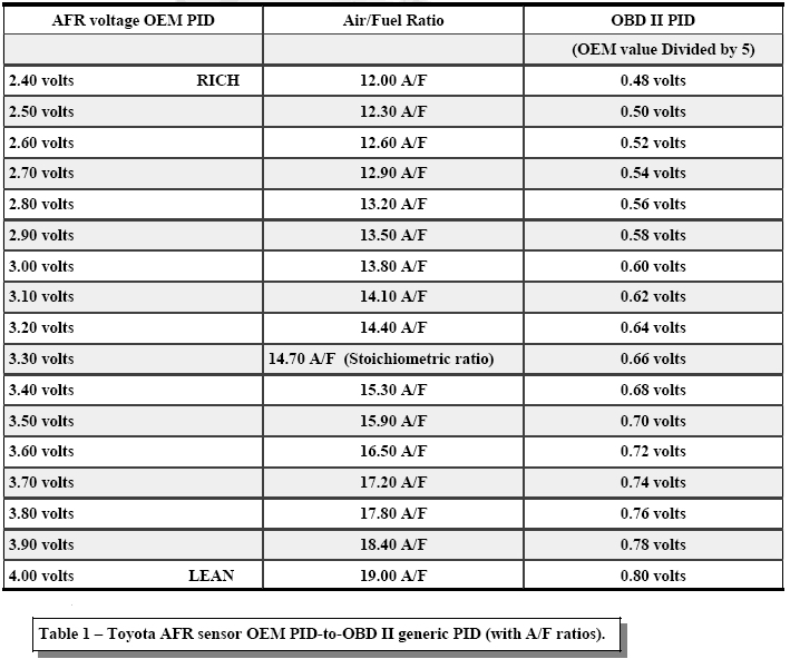

If you have a California emissions truck, it has a wideband up front, and you can use an OBD2 scanner, and correlate the reported voltage to AFR using this chart.

Do you have the link for that table? I tried to look at the picture, but it's a little fuzzy
