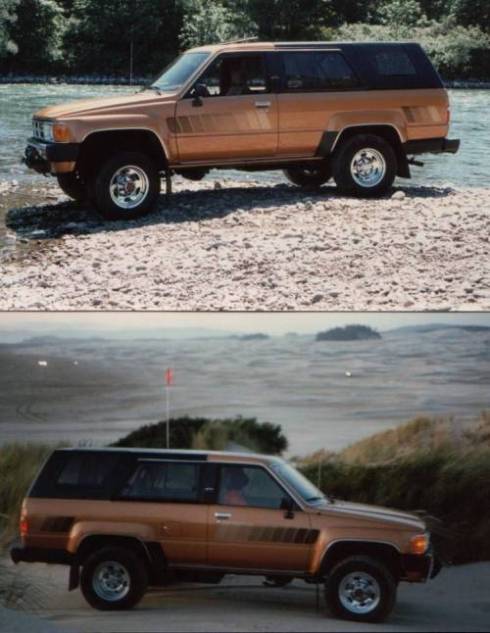

I ran 33s on 8" rims on my 85 Runner for a few weeks before I lifted it, and they rubbed at any opportunity - turning into driveways, turning full lock on level ground etc. That 4Runner appears to have some lift - look at the way mine was when stock with the 225s.
Made the picture a clicky, because it is kinda big
My buddies 89 stock with 31's and my old 89 with 30's stock suspension hight.
I know we didnt put a lift in 4runner - i would remember that. He did make new shackles to get rid of the sagging butt and cranked the torsion bar a hair to level it out. Besides he wasnt to do a SAS before he lifts it
I am also pretty cofident that I could mount 35's with my 4inch lift without problem - the only reason I dont is gearing right now. And then if I regeared lower I am in birfield bustin teritory and buying longfeilds and while I am in the axle rebuild phase a locker would be nice for the rear. Anyway my piggy bank is a little low for that..
To the original poster I think your question can be ansered easy - look for body lifts as pictured, lift blocks between the axle and leaf springs, finally count the leafs in the spring pack. I dont remember howmany a stock se has, but a lifted set will have more. If none of that exsist then you don't have a lift.
