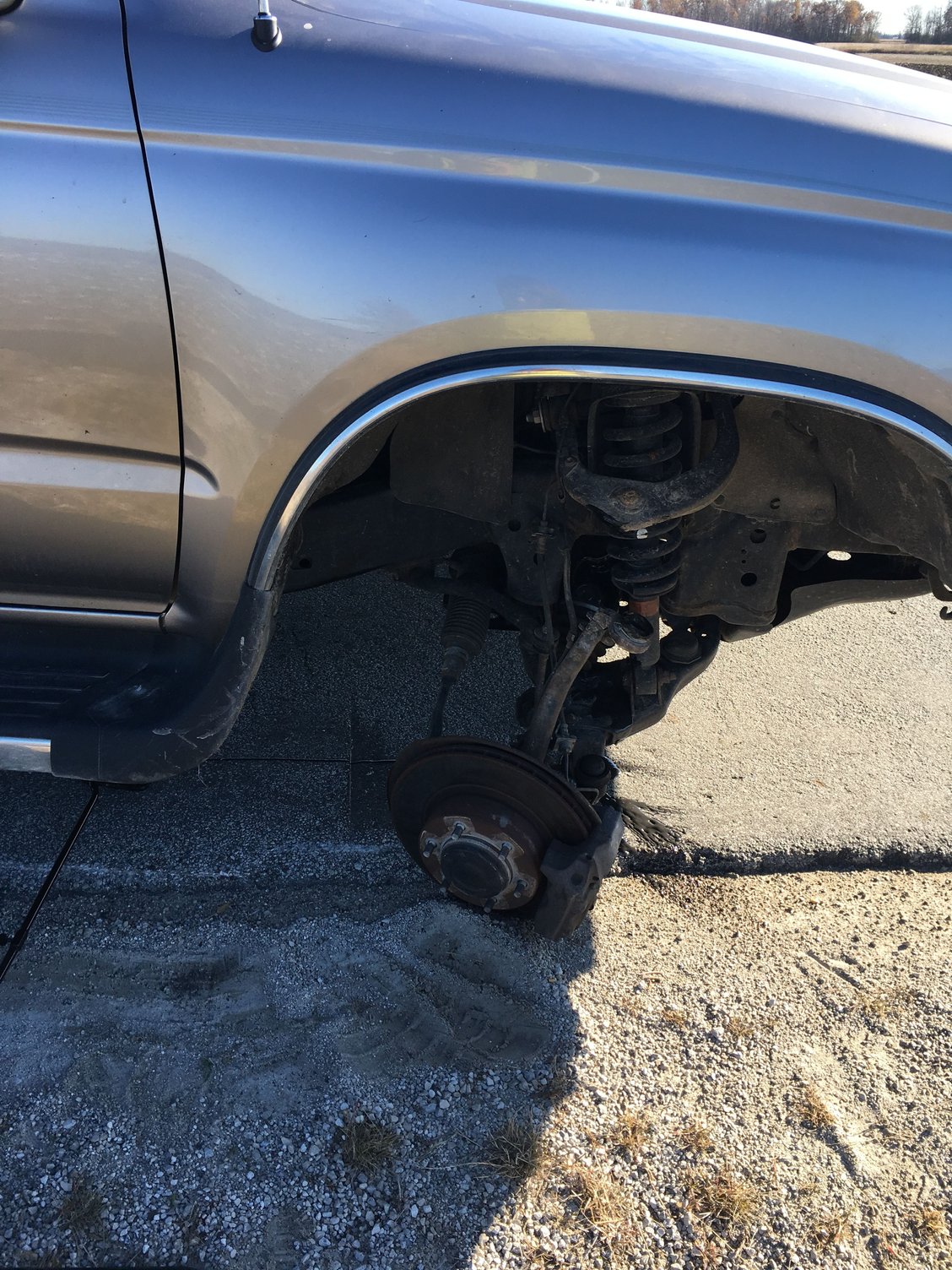

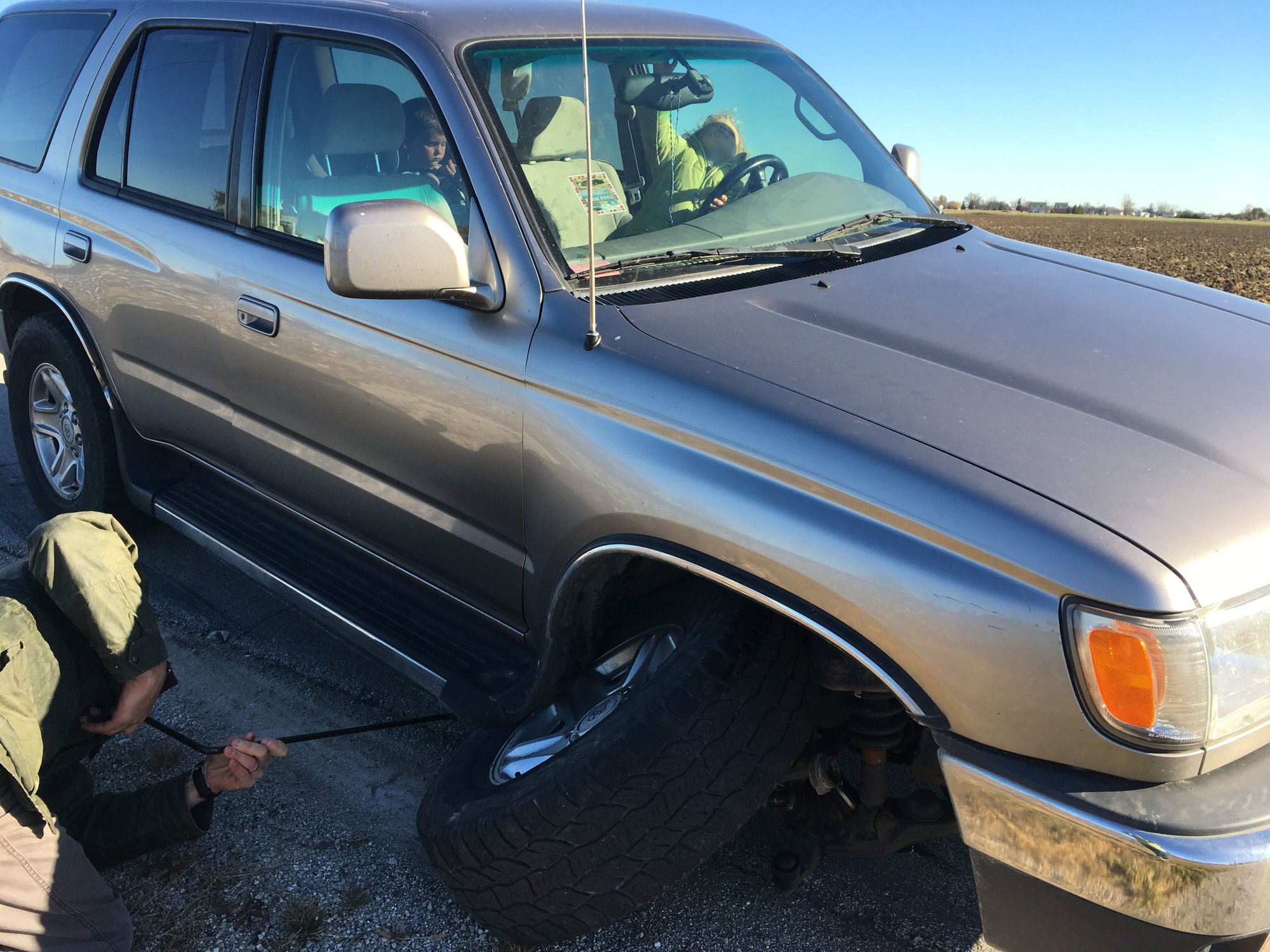

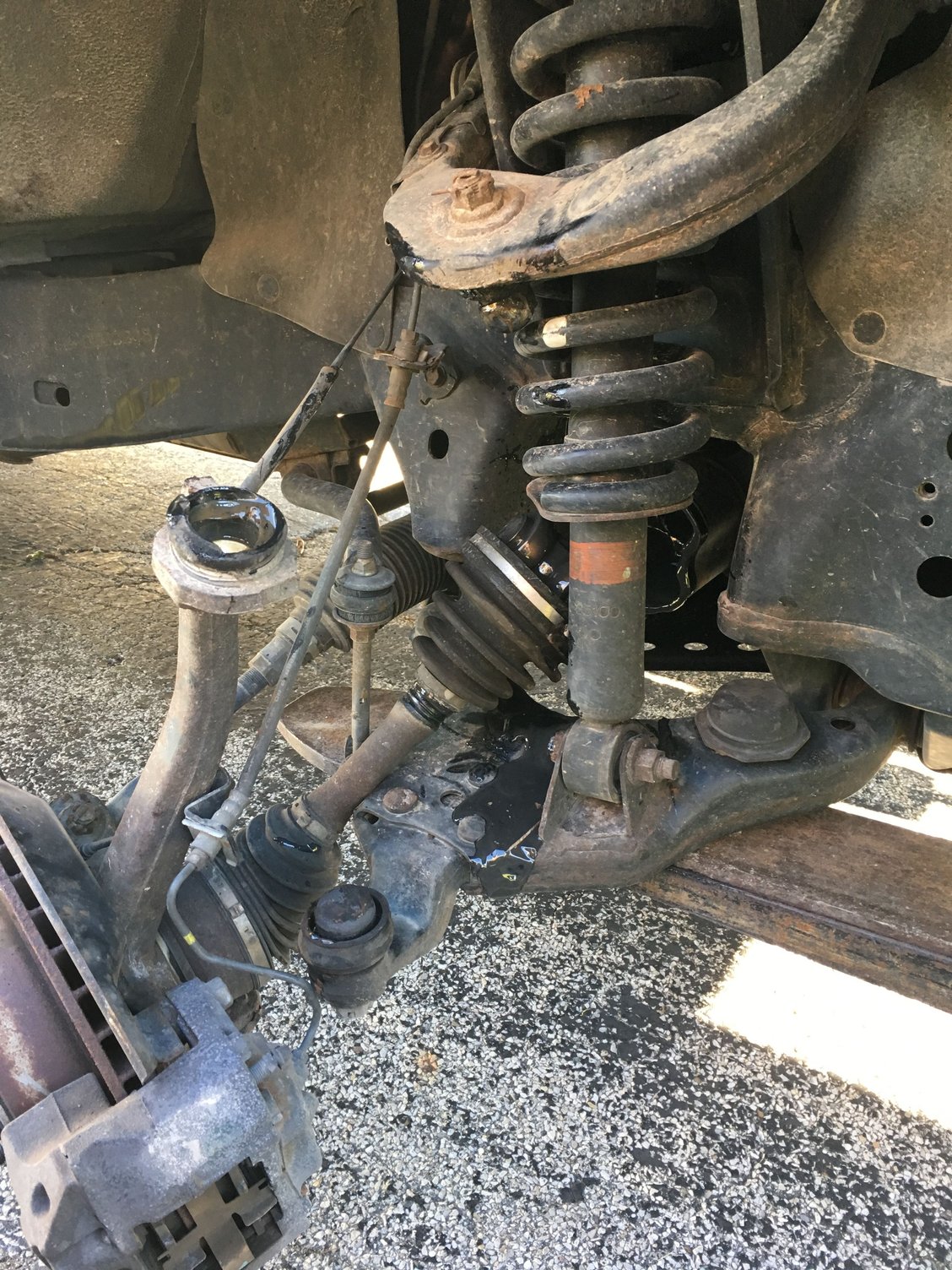

Hello, first ever post here. This seems like a very knowledgeable group so I hope you can help. We drove over some railroad tracks today going about 15 and this happened...
It’s a 2001 4-runner and it has always been so good to me! We were having some issues with the traction control beeping when we were not sliding but that may be another symptom. Is there an underlying problem?Do we just replace the upper ball joint and reseal the CV boots and call it good? Thanks for your help.

Looks like failed ball joint/s. Replace those, on both sides (if one goes, the other might not be far behind). Also, the steering tie-rod looks bent a little.

Hard to believe there was no noise or steering irregularities before failure.

It's the way they are under tension instead of under compression so as they wear the slop isn't noticed until catastrophic failure. Most 3rd Gen owners have switched to a 60k mile replacement timeline rather than waiting for play to show.
As has been said above, it looks like you're in for UBJ and LBJs on both sides, a tie-rod (you might as well replace both sides so they have equal wear), and probably an ABS sensor since that one looks like the knuckle is being held up by the ABS wire. Less than $500 in parts and a solid afternoon wrenching in the driveway and you'll have a brand new front end good for several years and tens of thousands of miles.

I agree with everyone so far, but nobody mentioned the CV, if you have the tool for the boot clamp you can try re-greasing and re-sealing, but I'm a big fan of replacement on them. And don't forget to align it when you're done with the ball joints and tie rod!

Tahnks for all the input! We got new ball joints and tie rods for both sides and will attempt to reseal the CV.
