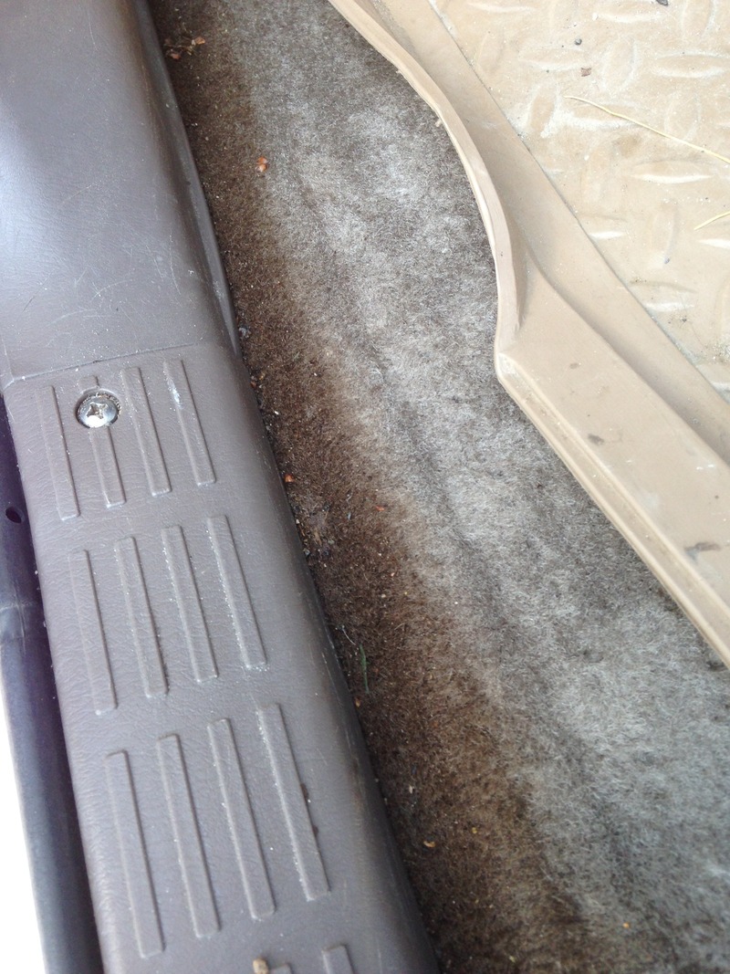

I've noticed a dark area for some time in the carpet right next to the door sill. I thought it may have been an old stain from spilled coffee - but it's definately damp to the touch.
Any thoughts?
- I purchased the truck new - it now has 331,000 miles
- I occasionally add some refrigerant to keep the A/C cool
- The A/C does drip condensate on the ground
- Coolant level is fine
- No sunroof
- Original windshield
- No accidents

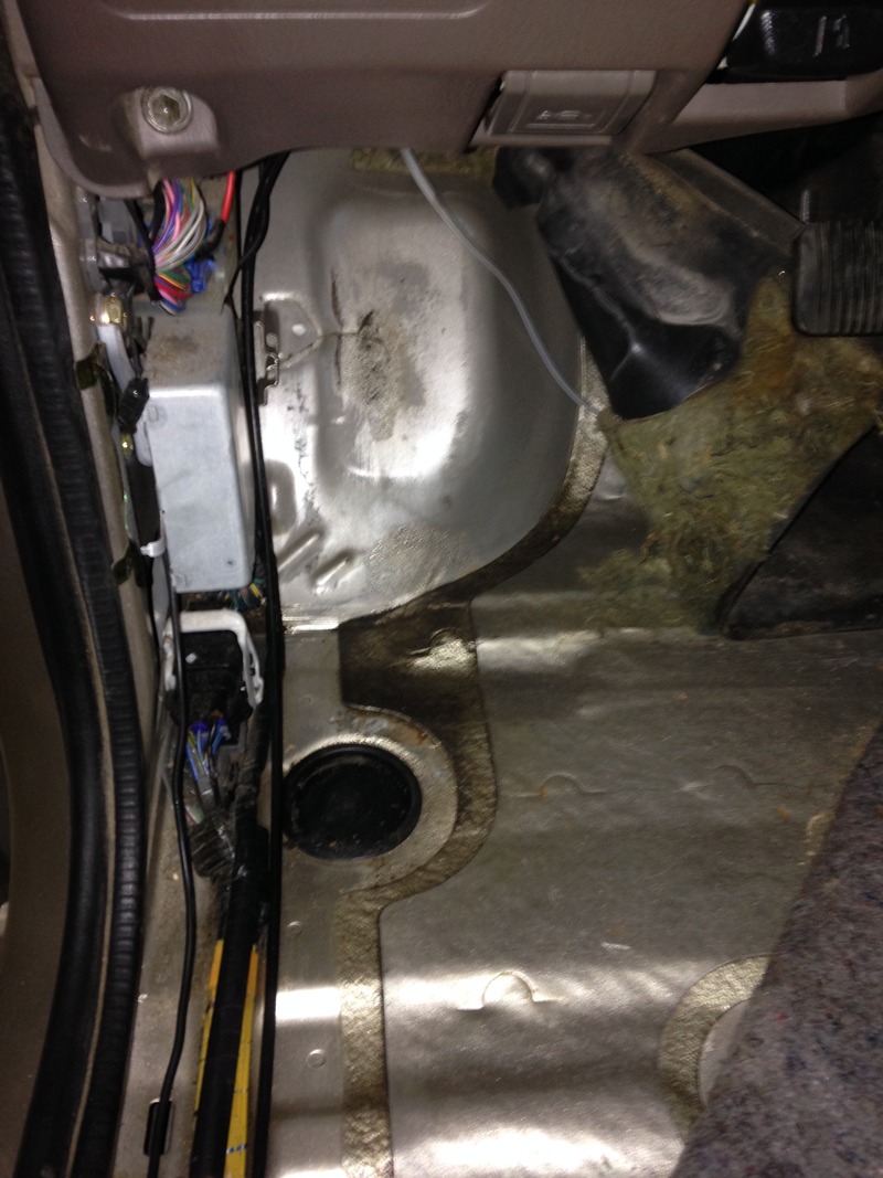

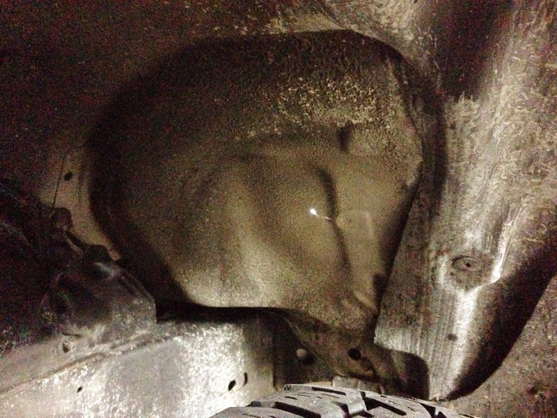

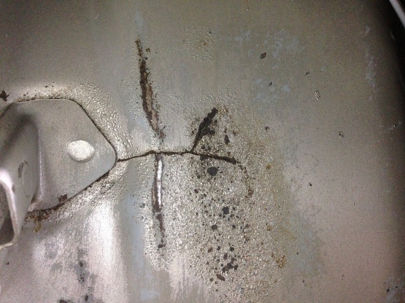

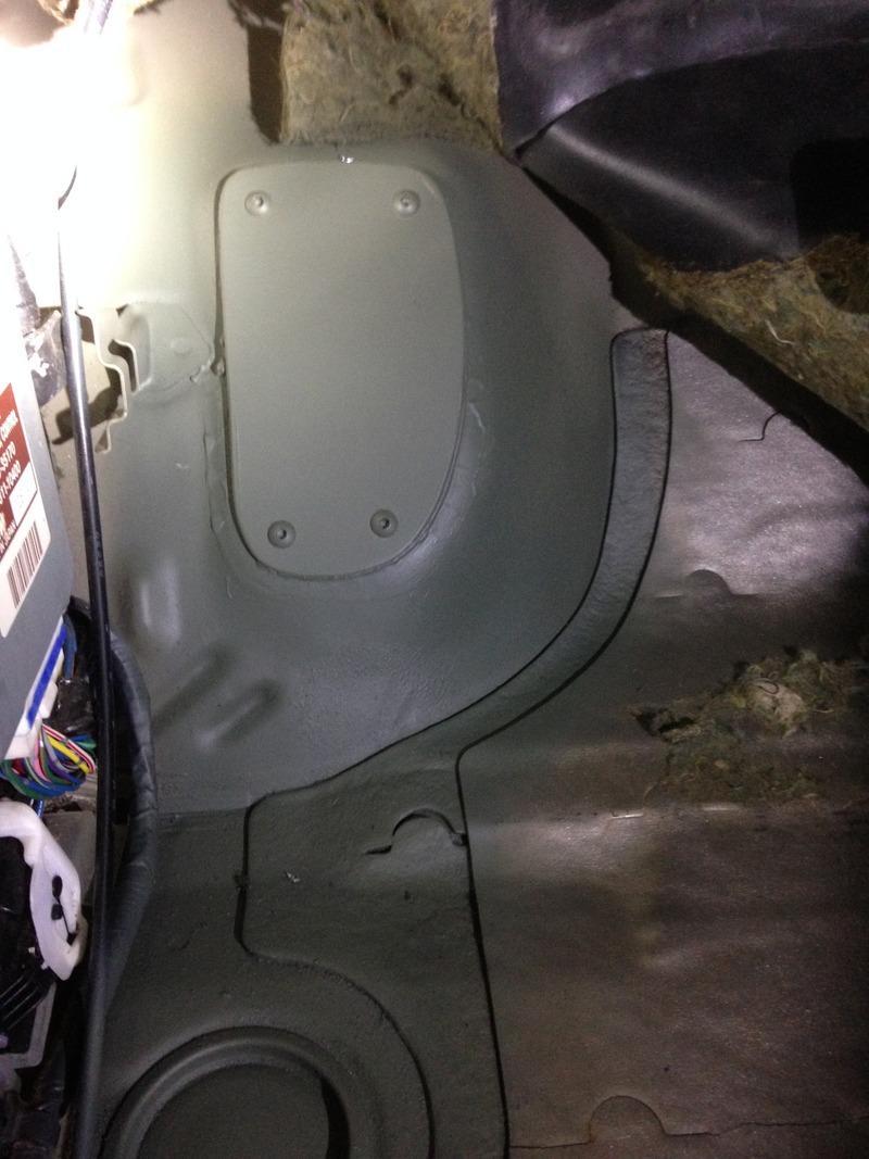

I believe I may have solved the mystery. This morning I removed the sill cover and then folded the carpet back towards the shifter. After vacuuming a bit I noticed staining in the area of the footrest. This staining continued to the floorboard and along the side, where the carpet & padding was damp.
I took a closer look and was surprised to see a Y-shaped crack in the sheet metal of the foot rest. Shining a light on the crack made it very visible in the wheel well. My theory is that the foot rest fatigued & cracked (it flexes very easy) which then led to the fender well underseal cracking. Driving in the rain would keep that area hosed down with water. Furthermore, I tend to run the truck through a touchless car wash with chassis spray quite often...

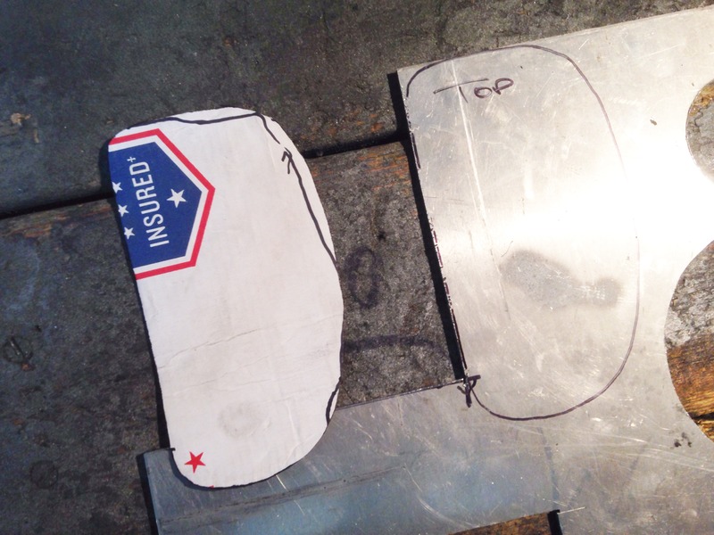

I have made a cardboard template and will create a plate from 1/8" aluminum to cover the entire footrest and prevent further flexing.
Instead of trying to remove the entire carpet, I'll try to clean it in place and leave it folded up for a week or so.

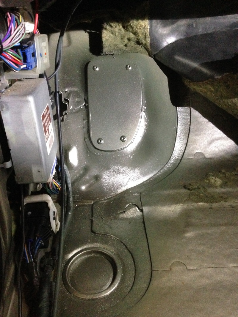

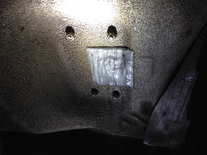

Almost done. I created a reinforcement from 1/8" aluminum plate, treated the rust, and then attached the plate using some stainless steel buttonhead bolts, washers, and lock nuts. I bedded the plate in OSI polyurethane construction adhesive.
Bush league, but hopefully solved.

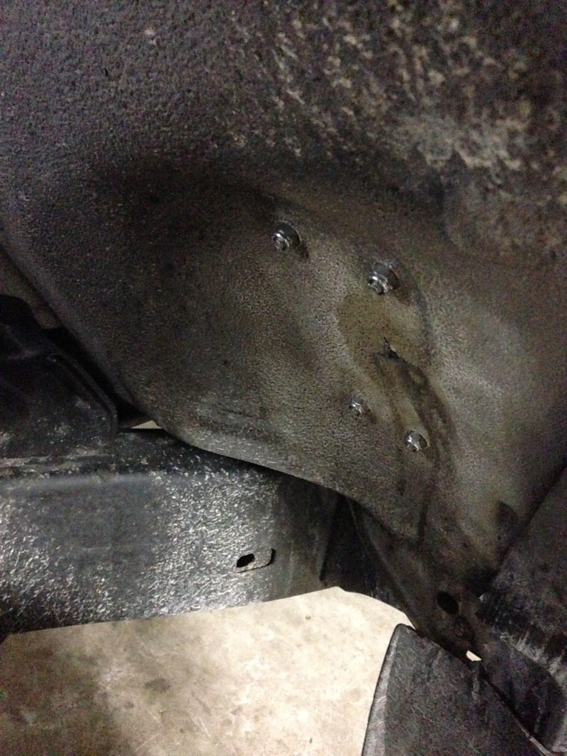

You called it. I did apply gutter sealant to the area around the crack (in the wheel well).
On the inside, some etch primer followed by a dusting of Dorado Gold (left over from a project)
